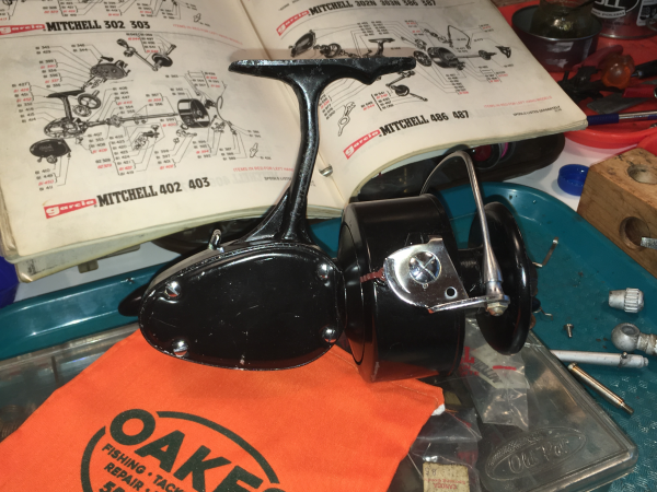

A Mitchell 302 HD Spinner bought on EBay.

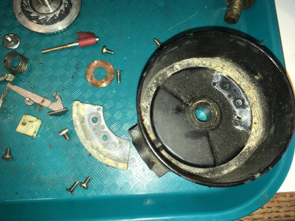

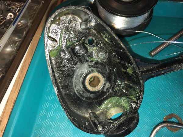

I have 3 or 4 crates of these — and they all seem to have the same issues — salt fused aluminum, corrosion, parts missing, drag stack not even close to original, pitted, any kind of grease the previous owner could find that gets mixed with salt water — then stored away for 25 or 30 years after the last fishing trip — with no service.
The grease won't even come out completely with lacquer thinner and an ultrasonic bath.

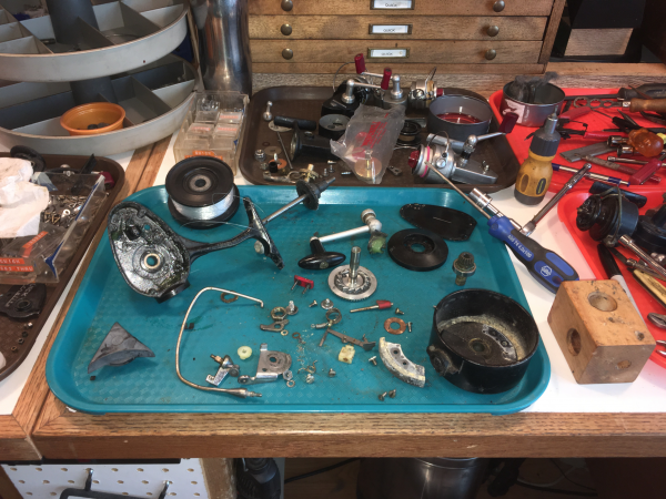

The only way to do one of these for me, anyway — is to completely disassemble it, check all parts whether they can be saved, or not — start the cleaning process which will take at least 2 hours — then see what is left over — and wade right in.
Fortunately, I do have a fair amount of new replacement parts.
The client knows little of the challenges involved.  They just send the reel in, with a note saying that the bail will not operate properly — can you fix it?
As soon as it is started to be broken down, the sand and salt becomes more apparent.
Of course, every salt-fused aluminum part breaks off as soon as I put a little pressure on it.
And the only parts that are not salt-fused or corroded — are the ones that are missing.
Anyway, no complaints — just take it head on...
I will post the results after 6 hours of working to restore functions and make it Salt ready.

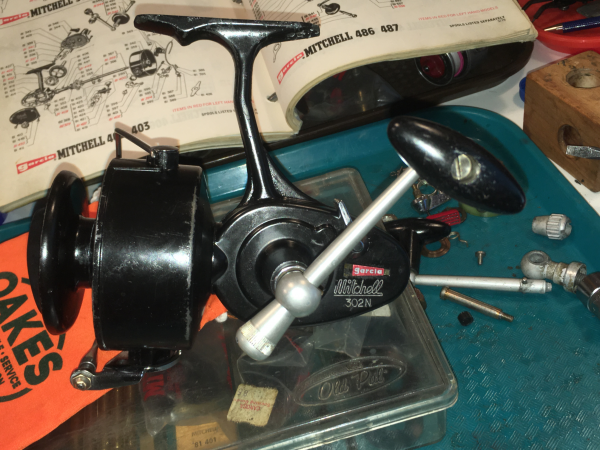

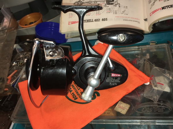

Started at 4:00 PM yesterday — stopped at 6:30 for dinner and to spend time with my wife.
Started again this morning at 8:00 — finished it up around 1:00.
It is never done until I would fish it myself with confidence.
Some are easy, some are more challenging — all part of the game — and it averages out...
mhc
Thanks for giving us a glimpse of your structured approach to saving these neglected reels Fred. You have a well organised production line from assessing the reel, cleaning, repairing or replacing parts, re-assembly and checking all works as it should before sending the reel home. I think I've said it before - your organisational skills are something to aspire to.
