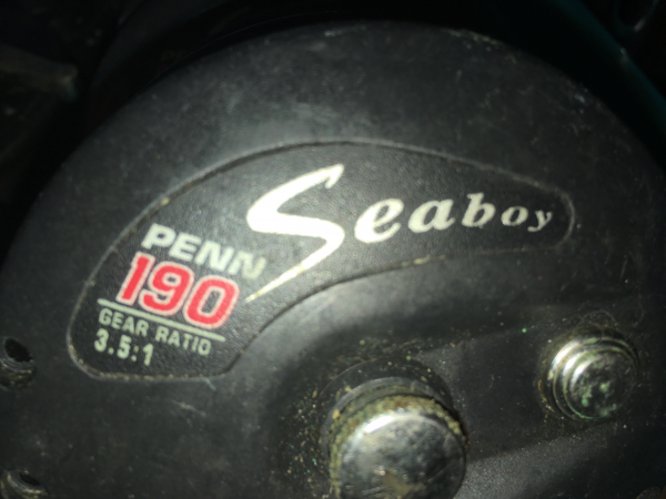

Lots of folks just walk past these reels, or think they are not very good because they are just a SeaBoy.
Check out the specs, the materials, the parts that make up this reel, and the line capacity.
Not bad...

I like the look of the Seaboy reels, don't know much about them, but might buy one soon to see how it fishes.
The thing to look for is the 3.5:1 gears. Just a little slower than a 112h.

Here is some info, Fred:
Penn Sea-Boy 190 SW Reel
Seaboy® An overall workhorse, the Penn Seaboy® was upgraded in 2004 for even better performance and durability. New features include a larger handle, machined-aluminum spool, stainless steel pinion, and improved free spool.
Graphite Side Plates
Black-Anodized Aluminum Spool
Manganese-Bronze Main Gear
Stainless Steel Pinion
Large Oversized Handle
Chrome Plated External Parts
Gear Ratio 3.5:1
Line Capacity 350 Yds/30Lbs
Manufacturer Part Number: 190
