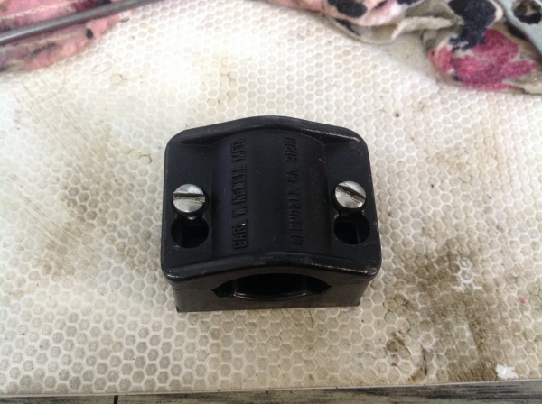

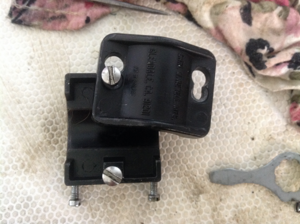

I have still been playing around with the idea of an adjustable Reel Clamp so I can go 'seat-less' on a few Rods I am building.
Here's the latest thought:
Now I have to find an Eyebolt that has ~2.5" shank while still keeping the 3/16" Eye diameter (without spending $6/bolt lollol)

That's a neat and novel approach. Even though the eye screws are toward the outer portion of the frame, does tightening of the clamp to secure the reel properly have any torqueing effect on the frame?
I'm guessing if the level wind and/or the spool function is not correct, that would be the giveaway.
Not at all knocking your idea, I'm just more curious than anything. If it works, you might consider doing away with the wing nuts in favor of regular nuts for a more trim installation. Not as convenient but definitely easier on the hands.
I have a gent that comes into the shop that lashes almost all his conventional reels down and I've commented to him that it must be a pain when you have to remove the reel. I was surprised when he said, no big deal,  ...  he just removes the side plate screws that secure the foot, and pulls the reel off leaving the foot in place. Simple and interesting way to go, I guess.
Please keep us posted as you go forward.
.........................Lou
I like your way of thinking Steve, I could see that working. I would recommend turning the eye bolt opened end towards the outer side of the reel so the line doesn't get caught in therte.
Thanks for sharing your ideas with us and keep us posted on your progress.

The Wingnuts are just from the Clamp off a 500.  i have cheap Nuts that came with the Bolts.  If using Nuts, I would lean toward Nylocks, just to make sure they stay put..
The Eyebolts are closed, but their end is a little rough, I will turn them around.
My concern is shearing the Bar Screws.  Once i had the longer rear Bolts, I will have to tighten til the Reel is firm and see what my comfort level is with the stress.  I have no method to test their shear load.
Lou.
If that Gentleman comes in, recommend the Plate-type Seat.  He can lash down the Seat, and easily remove the Reel without partially dismantling the Reel.  The chinesium ones are cheap as chips but even the Fuji from Mudhole is only a few dollars:
He can lash the Seat down at both ends (see the 'ears') and in the middle.
I will get back to you once i get the other 2 Bolts
