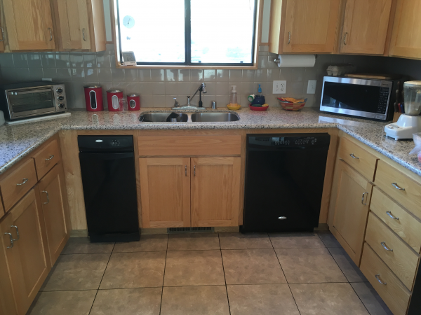

John Hoyle had some questions about a dishwasher I was installing.
Rather than a PM, I will show a few pics of the installation.
The size of the opening is 24"x24"x35" high.
New Drain and fill hoses and direct wire hook up.
The only main issue I ran into was the ceramic tile was not under the Dishwasher.
This wouldn't allow it to slide right in. I had to crank the front legs up, and then level them back after sliding it in.
The wife is very Happy.
Nice job Darin.  I had the same problem with the tile when I did mine.  Adjusting the height was a pain.  Dominick

To tie the front top tabs I gorilla glued 2 1/2 inch plywood strips and screwed the tabs on to those. Worked pretty good, it was been 5 years and still holding.

One thing a lot of installation instructions don't mention is to make sure your drain line loops up to the bottom of the counter top before it drops back down and enters the disposal or drain fitting. This creates an air gap. Some say it's not needed because the pump has a solenoid valve. Most plumbing codes, regardless of the valve, require that loop.
As far as no tile in the DW hole, if the under counter height allows, we generally add a shim a couple inches wide the same height as the tile on each side so the DW will roll (adjustable wheels in the back rather than legs) or easily slide back into the hole with little adjustment to the front legs.
The Maytag has wheels on the back. It would not fit without turning the legs down in the front first.

Gobi, I have sold surface counter tops, but there is wood underneath. I screwed the new tabs right in.
I initially set the legs too high and it made the top of the door hit a smidge. I had to lower them a tad more to make her happy.
