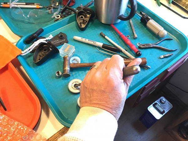

#7
Another technique that works, Pete —
From the underside of the gear — use a punch or screwdriver with a sharp edge to catch the inside edge of the drag washer — then just tap it out with a hammer.
It might break apart — no big deal.  Just scrape out as much as you can — then finish off the inside of the gear with a small stiff steel wire cup in an electric drill.
Use safety glasses and a respirator mask — rinse and clean up the gear — and you are ready for a set of CF's with SS discs — or HT-100's with SS discs — Cal's drag grease worked into the fiber discs — and you are done.
