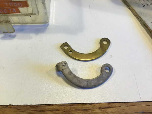

I am wondering if the arch shaped occilation arm that goes from the main gear to the bottom of the spool shaft on a 285 finessa can be changed out for the arm (with its attachments) from a 330 ?
My reason for this is that I bought a 285 which usually comes with 2 arms, one for right hand cranking and one for left cranking. This reel has only one arm and it is for left cranking and I crank with my right hand.
The 330 has only one arm, but it is convertible to left or right.You just take the little block on the bottom of the arm and put it on the other side of the arm.
I will not get the 285 until another week, so I might be lucky and it will come with the extra arm.
thanks
Greg

Hi Fred
Sorry to waste your time. I could have saved us both some bother by just looking at the bottom of the spool shafts on these reels and how they differ, resulting in a no go for my proposition.
The distance from connection of main gear to spool shaft is the same on both arms, BUT, the bottom of the shafts differ and the little connecting screws differ in diameter.
Greg
