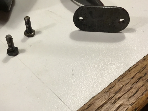

Got an old timer here that was obviously machined slightly askew.  Any suggestions on how to correct it or am I better off leaving it alone?  No idea if it will effect the casting since I have never used it.  I don't imagine it does anything positive for it though. Photos make it look worse than it is, but it is definitely off.  Thanks, Joe.

JOE    could  it be   that  holes  for   mounting   foot   are  oversize  in   the  mating  parts.?  maybe loosen  screws,   see  if  you can  move  everything back into allignment.

I checked one of mine, Joe —
The holes in the stand have a little play in them.   Maybe a couple of Mils (likely the same as is showing off a bit in your photos).
So, if you wanted to — you could just loosen the (2) threaded hex bolts with a 1/4" wrench — then just move it slightly over — then retighten.
I believe at some point in the last 50 years, it was serviced, then just installed sloppily —
No big deal to just loosen each a half turn — and move it over.

Well per Fred's suggestion I was able to straighten it out somewhat but its still off a bit so I wasn't totally wrong, i.e. wasn't machined perfectly...;D.  Thanks for the replies.

if  you  want  to  make  it  perfect  fit   just  file  one  hole   a  bit  oblong     until   you get  it  perfect  should  only  be  a  few  thousands  needed

Yeah. Maybe with some lock washers to keep it in place. What kinda reel is it?

Its a Shakespeare Sea Wonder 2090 ..  Has anyone notice if this effects the reels performance?  I haven't had a chance to try this one out.  Thanks for the replies...Joe.
Quote from: basenjib123 on March 18, 2019, 04:18:04 PM
No effect whatsoever, Joe. That's one of those things that you are best if you put it down and walk away. Get it out of your mind. There is no real need to fix anything.
