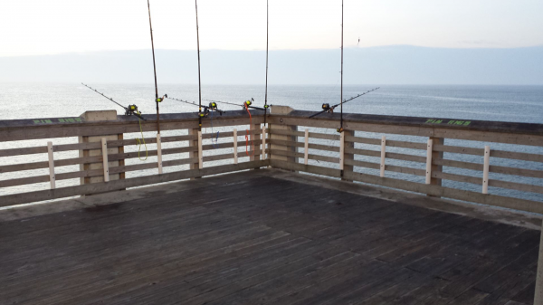

John do yall use pier rail clamps down there? We use the Down East Salty S-10 clamp for our fighting rods and set the anchor rods vertical in the rod holders
Like this

Chris, absolutely, where the pier rail will allow. They are the way to go.
Greg: Note in Chris's pic, there is a conventional outfit nesting horizontally in  the clamp he's referencing. This is the fighting rod. The vertical surf rods you see are "anchor rods" actually serving as a vertical "outrigger", like a Green Stick on a tuna boat. The anchor rod only has a grapnel type sinker, made out of all kinds of things- welding rod, 16 penny nails, heavy wire, etc. molded into a lead weight like a sputnik sinker, just heavier. This weight is chunked as far as possible and pulled until stuck well in sand. Then a "pin rig" is attached to anchor line. Its essentially an outrigger release, made with a snap or shower ring, a short length of leader (appx. a foot) egg sinker, and a clothespin. The fighting rod will have a 5-10ft wire leader at the business end, attached to said mono leader with a swivel. This swivel goes into jaws of clothespin (hence pin rig), and is jockeyed out by putting fighting reel in free spool and bouncing the fighting rod to lower the bait (live spot , menhaden, bluefish or whatever) so that it sits about a foot deep in water...splashing around and causing an attraction. There are diagrams around but i cant grab one at the moment. Somewhat similar to a slip rig used for ulua, i think, just using two rods. Usually we put a hi vis cork or float on the mono between the snap and the egg sinker on the pin rig so you can see where your rig is easily. When fish hits, the swivel pops out of pin and the pin rig slides down to the anchor so you are fighting the fish directly, just like from and out- or - downrigger. Hope this is not too confusing.

The c-clamp doesn't actually hold the rod; there are two of them on the rail and they bracket a pop-up cradle that holds the rod and allows you to pick the rod straight up. It is a commercial one piece assembly. People weld pipe to big c-clamps and all sorts of things but what Chris shows is the Cadillac.
