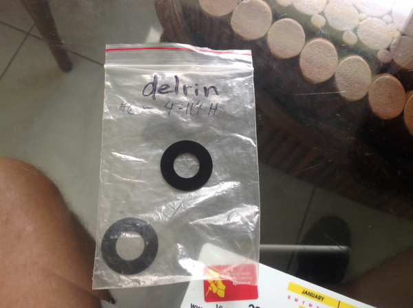

Wherever you ordered the drag stack from — order an under gear washer of your choice also — it is just another dollar, or less — and they will not ship out the order until early tomorrow morning.  So if you do it today — no extra shipping cost.
Do you have a part number for that??
Paws, and enjoy Life !
#21
That last picture you took was a good one, lot's a detail. Should be a 4 - 115 for the stock Penn washer( "under-gear"washer). Best IMHO is the delrin that Smoooth Drag would carry. I think you gotta take apart the right side-plate to replace that'n. PM me if we're on the same page and I can eaisly mail you one, n/c.
take the reel apart & do it propaly, then you can place the undergear wash in there, I am sure you can manage it, make sure you use nice fitting screw drivers, work close to your body, so the screw drives dont slip of & cratch your chrome rings, you can do it, I have my money on your, take your time, if you get confused, there is plenty of help here, a delrin washer under the star is a good idea to, cheers Don
