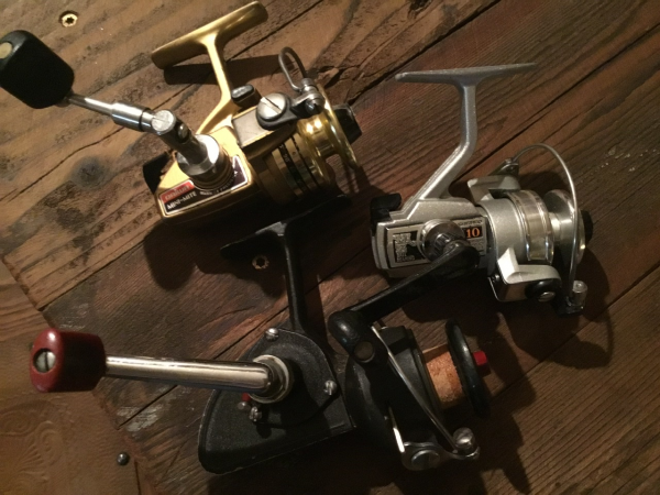

I found this little Shimano 10 at an antique shop for $10, I've got a soft spot for some of these older Japanese reels.
