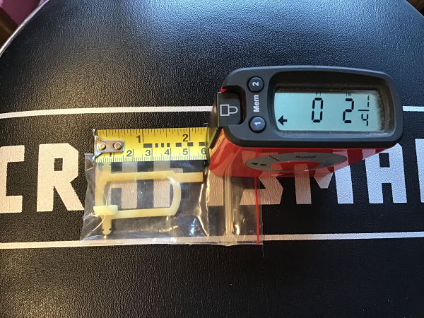

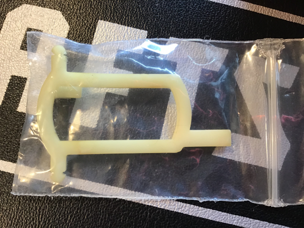

#9
Assuming you already got the part, Bill — or have it ordered...since you have not posted a photo measurement ID as of yet — so that is good...
Here is likely what you need.
Let us know if you still need it — or have it covered.
