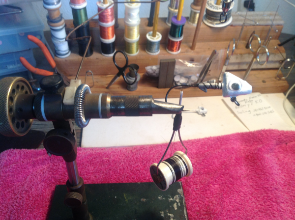

Here's a 3/4 oz. triangle head jig with a nice long hook shank. Probably designed for a plastic/rubber body add on. Therein is another great aspect to jigs: ability to change to diffrent body types or colors.
Start with a thread base on a prepaired jig head (painted, eyes added).

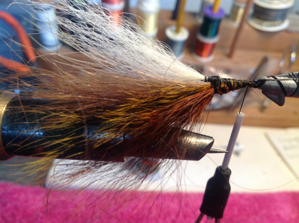

I like to layer the colors kinda like the naturals. Baitfish: white belly; middle-maybe 2 colors, one a little darker than the other; dorsal/back- the darkest of the naturals overall color(brown on this'n). REMEMBER: the upward riding hook side will be the back of the critter. Best to start with the tail, as the body dressing will cover it, as you work forward. A drop of glue on each section( tail for example) will strengthen the fly.

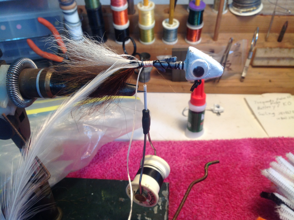

After the tail's completed, all the body components should be tied on at their ends. The floss in the last picture is to even out the body and to try and get a taper---narrow(tail) to thicker(head).
I use white materials on the body and head sections as much as possible, cause it's much eaiser to use waterproof color markers get the layered effect. Good quality artist's color markers are best.
Wrap the main body materials forward(pipe cleaner here). Then the dressy stuff, in this example a long feather from the saddle area of jungle cock( this would be an example of a material type best bought from a fly shop). Some type of thin wire twisted together with the feather, then wraped forward might protect the feather shaft from being cut by fish teeth.
I like to add what would be comparable to a wing on a streamer fly, up on the neck area. This can be tied in before or after the body is completed. I used maribou here because it has great life-like movement. To me, the secret to life-like artificials is individualized movement of various parts of the jig/fly---think fin and tail movement on real fish.

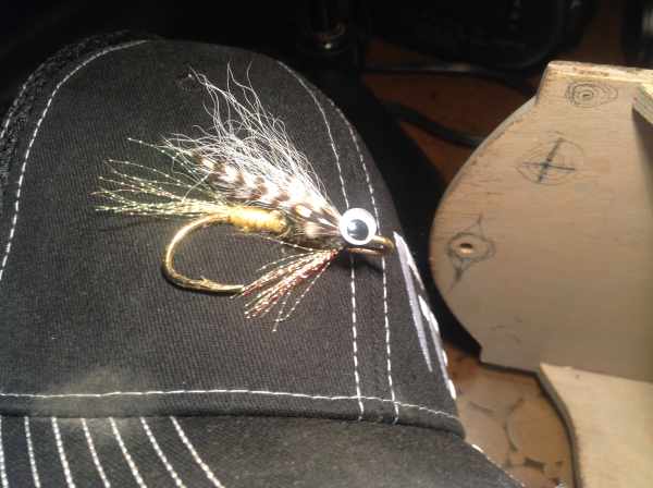

This weekend the wife and I are attending a church conference in Honolulu. If you look close enough you can see that it's not  just a flashy streamer fly on my "Lucky 13" cap, but a tie clip fly. Yep, I'm gonna remove it and wear it with my white button down sport shirt and yellow tie. And I ain't gonna let "Mrs. Proper Protocol" tell me I can't do it!
Good stuff! Greg graciously sent me one of these excellent pieces in the box of 130 Sailfisher he very graciously sent! Really good-looking fly.

Looks pretty "fishy" to me !!  Seriously, great job !
Cor
If I were a fish I'd eat it off the picture, looks so good!

Yep, I'm gonna remove it and wear it with my white button down sport shirt and yellow tie and she ain't gonna change my mind!
Famous last words... ;D  Dominick

Yep, let us know how that works out for you...before, during, and six months later...🤦‍♀️...😀
Good Luck, Fred
Yup. Misses "strict protocol". "No, that will be improper at a church meeting!" Usually she lectures the issue to death and I give-in.
