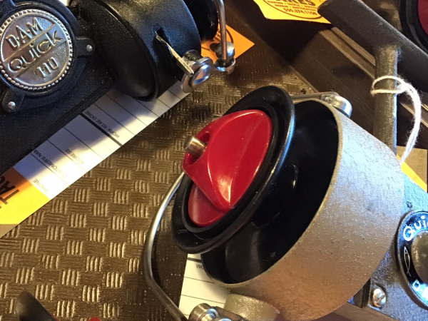

Yes, it works well on those, Andrew --
Here is one that I cleaned with a toothbrush and Penetrol on an old 60 year DQ 238.  Let the Penetrol soak in for around 15 minutes -- then wipe it completely as dry as possible with a microfiber cloth.
The white fading on these generally comes back within a day, or so -- with other products.  I treated and cleaned it with Penetrol last Sunday afternoon -- 5+ days ago.  Just checked it before it gets shipped out tomorrow.  Still shiny black.
Pretty easy, and seems to work well.  I have used Penetrol for a couple of years now.

Christopher M Songer
They cleaned up nice with the Penetrol and sold fast.
Always go forward, never go straight
Good job on those Line Counters, Christopher!
