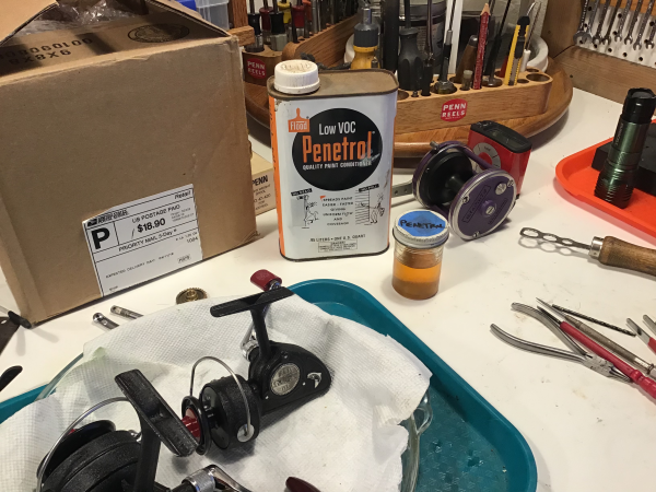

head light restorer, followed by Back to Black that you use on automotive trim will improve it a lot.
Penetrol works.
Around $9.
It is great on crank knobs, drag knobs, plastic or graphite frames and bodies, automotive plastic or rubber trim, etc..
I keep a little salmon egg jar on my bench.
This stuff is like a Lazarus treatment.
Dispose of your application rags, as they will spontaneously combust if allowed to be piled together without air drying first.  Use precautions as you would with any solvent.
The results will astound you.

Christopher M Songer
I was thinking of Back to Black as I had used a similar product on my car's interior trim. I used a liquid rubbing compound a month ago on my 2001 Camry head lights with outstanding results, but I was thinking of going to baking soda and a scotch bright pad first for the next reel. I have 4 of these reels and will try different techniques to see what is most efficient. Not going to spend a lot of $ or time on these reels, but it will be interesting to see what works. The first pic below shows the results of a second WD 40 application using a scotch bright type pad that had some liq rubbing compound lingering in the fibers from my head light work last month.
The second pics show one of the reels on the right that has not been touched yet. All 4 started out like that one.
My original post shows the reels after one cleaning with WD40 and tooth brush. Still faded and chalky. Penetrol looks like it might have many uses around my garage and work bench. Thanks everyone.

Used the Back to Black, WD 40 and Penetrol on the reels and have my results to share.
First pic shows all 4 R->L unrestored/or cleaned. WD 40 only, Back to Black only far left Penetrol only.
2nd pic close up of unrestored and WD-40
3rd pic WD-40 and Back to Black
4th pic Back to Black and Penetrol
The back to Black was easy to use as was the WD-40. The Penetrol had best results but was more difficult and needed more precautions to work with.
Over all the WD-40 and the Penetrol seemed to penetrate the reel body.
I suspect since I use WD-40 to clean old fish scales, dirt and grease off anyway it may be "good enough". For better results use Back to Black after cleaning with WD-40. Best results most likely clean with WD-40 then apply Penetrol.
