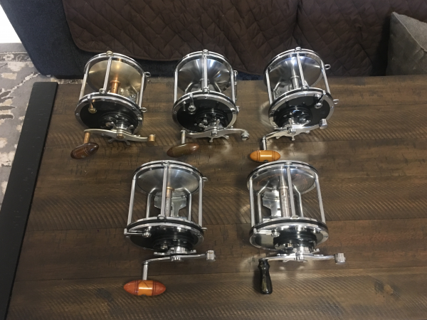

Okay I bought this first reel with the box and 1937 catalog and the Penn packing paper in it. As you can see box, catalog and reel are all in really nice shape but the reel has the big top harness lugs and has the smaller front lugs with rod brace. Also it has the torpedo style knob. My question to all you Penn gurus is could this reel have been a late 1937 production reel or possibly a latter 38 reel that was put in box with 37 catalog ????? Can this package be correct ??
I also have this 1937 12/0 that I am sure would be correct for box and catalog but reel isn't as good as the one that came with it. Which one would you guys keep with the box and catalog ?         Thanks !!       John Taylor

Col : There is a picture in the 37 catalog that shows a Senator not sure if it's a 9/0 or 12/0 but same knob as my early 12/0 and no harness lugs !! And I do plan on keeping both !!   John Taylor
John in that picture I think its a 9/0. Scalloped head plate bushing and no oil port handle.
John,  I would say it's a '38 due to the harness lugs and handle.
Also, that's a 9/0 in the photo and the 9/0 handle is different than the 12/0 pencil handle.
Incredible piece to say the least,
I have a copy of a Penn advertisement June of '38 that shows 12/0 with log knob, which leads me to believe the 12/0 pencil knob was already history by then. Now try and find a 12/0 with a log knob....ain't happening.....which leads me to believe late '38 12/0 had a torpedo knob like yours. During this time is also when the coin edge cb was redesigned with a higher profile
Ted

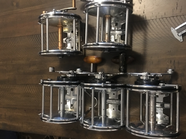

John one other thing I have noticed with my reels. The location of the hole in the spool changed at some point. On the earliest reels, the hole is located closer to the side flange. I don't know when exactly the change was made but at some point the hole was move 1/8" or 1/4" closer to the center.
This is true for the 9/0 reels as well and the later spool is not interchangeable with the earlier spool. I tried to swap one into a 1936 9/0 and the spool shaft was bigger and was a no go.

I got together all of my first GEN 12/0 reels and one early second generation with hole in the school. I found the hole locations have moved twice. Measurements are from side flange to center of hole
1937 first year = 10mm
3 subsequent first gen reels = 17mm
Early second generation prewar = 23mm
There is a slight consideration to be made here. The 1937 catalog was published in two editions. Yours is the later edition, so your reel is close to a 1938 model.
Just saying.
The first edition does not show the 100 yard Newport model.
QuoteJohn,  I would say it's a '38 due to the harness lugs and handle.
The rules about how Penn reels are made are very loose. This 9/0 is on Ebay right now.
Mike, Yep,  I am aware of that reel for a while as I know the owner of it.  I was just saying the photo John posted of the catalog is a 9/0 pictured not the 12/0.
Also, the difference in the 9/0 pencil handle and 12/0 pencil handle is length.That's all I can see being different.
