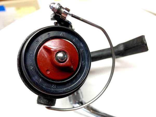

And here is the reel after being worked on by Fred!
The reel is absolutely stunning - NOT a mark, scratch or smudge - NADA!!!
Look at the medallion - FLAWLESS and BEAUTIFUL!!!!  A Master reel restoration from Fred.

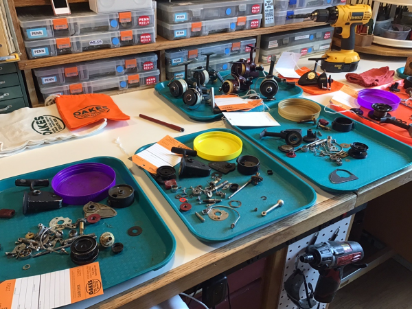

When these DQ's leave the bench -- they are as new -- regardless of how rough they arrived...
Process on Wayne's tiny 110 DQ Microlite was --
Inspection
Full disassemble
Ultrasonically cleaning of all parts
Re-inspection of all cleaned parts
Burnishing of every part -- whether visible, or not
Polishing of each part
Replacement of any worn parts with new parts
Exterior prep for oven-baked wrinkle paint
Paint & baking
Assemble using modern synthetic lubes
Micro-tune, adjust, test
Recheck all functions and parts one more time before bagging and sending back to owner
This may seem like a lot of work for just a reel -- but I never grow tired of these great old reels.
