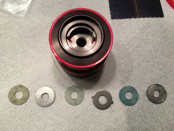

Both reels have a six washer drag stack with similar design. The Shakespeare spool is painted cast aluminum alloy and has a metal click dog and spring. The Penn spool is brushed aluminum and has a plastic click dog/spring mechanism. The Shakespeare fiber washers are leather that are supposed to be oiled. The Penn washers are hard fiber of some type. The Shakespeare washers are larger in diameter so there is more drag surface when in use. Both drag stacks are kept in place with a C ring.
