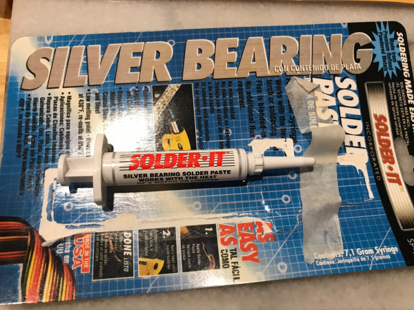

Thanks mr. Octi,  your solder in the link appears to be 70% silver .   Maybe the low percent silver is for brass, silver,or copper.   Here's the things that I have tried.
Another flux was tried, it's like a gel,  grey, and another silver bearing solder about 5% with no better results.
I,m going to try again with a higher silver content solder when I can.   Thanks for sharing your knowledge.

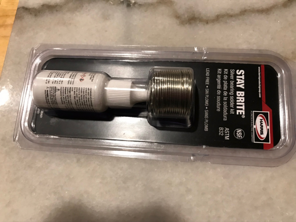

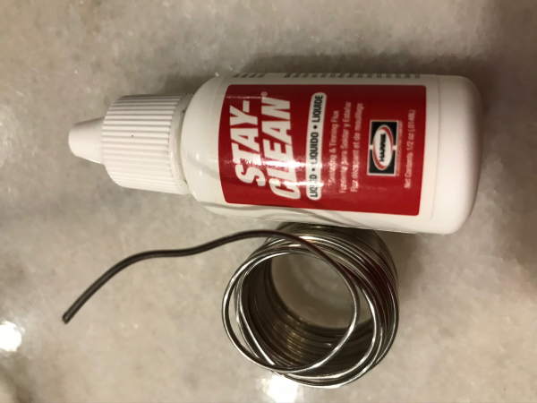

I couldn't make any of those products work for me.  Try the solder in the link above with Stay Silv paste flux.  Don't be stingy with the flux either.  Put on a glob of it.
It may be helpful to others to notice that the higher content silver wire/solder is quite stiff more like most wire compared to 3-5% silver wire that is very soft and bendable.  The black flux is made for the higher temperatures and stays on good butt it did not work for me using brass rings?

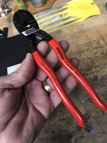

My new nippers and my new butane torch arrived today and, just when I discover that my other butane torch, ( the one I purchased last year for the purpose of igniting the sawdust in my bbq cold smoker, has a lever to increase or decrease the flame and I've had it set at its lowest setting all this time? Doh!  I hate it when I do that.
Here's the new nippers and torch kit.

    Your Knipixx cutters are my next investment,   Like you said,   I hate it when I do that. :D
