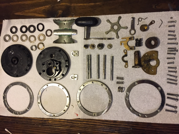

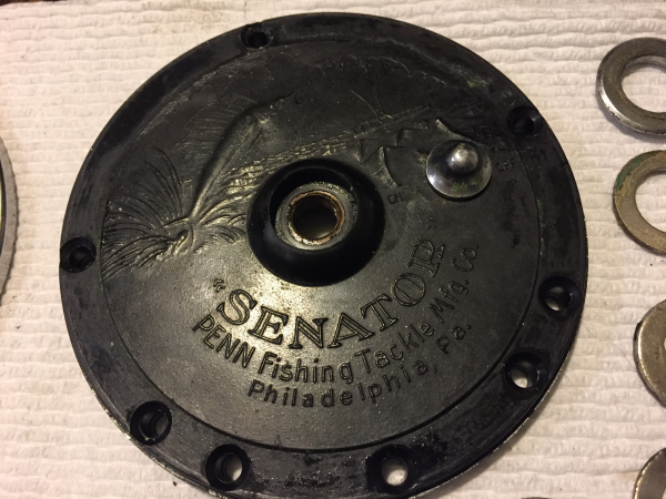

Picked up a Senator 114 6/0 off ebay shipped for $39.  Going to use it for shark fishing from the beach in Texas.  This is a BIG reel, to me anyways. I know there are much larger ones Penn made and I can't imagine the size and weight of them!

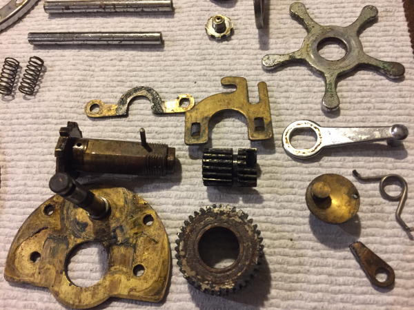

Anyway, got this one all tore down tonight and soaking in degreaser for 24 hours and ready to rebuild later on this week.  I will be looking to slowly upgrade this reel before summer gets here.  A few things I want to do right off the bat is carbon fiber drags.  What is the best way to update the drags?  Next would be going with stainless steel gears and whatever else I can make more robust in the guts.  Depending on the cost to upgrade to SS I may put off that till her second season.

Beachmaster, if you decide to go with the 114 6/0 I would just go with a new set of CF drags (5 stack) from Mystic. It looks like it already has a heat treated steel main gear, the pinion gear is s/s. You can stay with the brass gear sleeve until it starts to round off where the handle attaches and then go for a s/s gear sleeve & dog. Take Daron up on the 114H reel it is a better reel for hop ups. The gear ratio on the 6/0 is 2 to 1 & the Special Senator (with red or moroon plates) 114H is 2.8 to 1. There are more hop up parts available for the H model, plus the H model has ball bearings to support the spool.          Rudy

You can be that reel from Daren is "Good to Go" and you have a seriously top level piece there!  But as Rudy pointed out - that 114 that you started with is a choice reel; appears to have steel gears so a good cleanup and an aftermarket drag and it will fish hard for many years.
