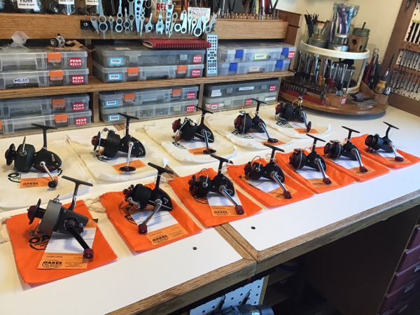

If you would like to have your DQ 110N reel restored to as close to new -- it would run you $50, including any parts needed.  This includes a full restore, including paint.
Shipping would run another $18 for the round trip, via Priority Mail.
Here are some that were restored for a client a couple of months ago -- all but one, were much worse than the condition of yours.
He was happy with the outcome of each reel -- and is in the process of sending out another group of 35 DQ reels.

Holy smokes that is awesome Fred!  When I get home I am going to JB Weld the nub back in, have to do that anyway, then I will see how that holds up.  I won't be doing any fishing other than panfish or crappie with this reel. I'll send you a PM later on.  I may use your service in the future too!  Right now I just enjoy working on reels myself and I am just starting out.
