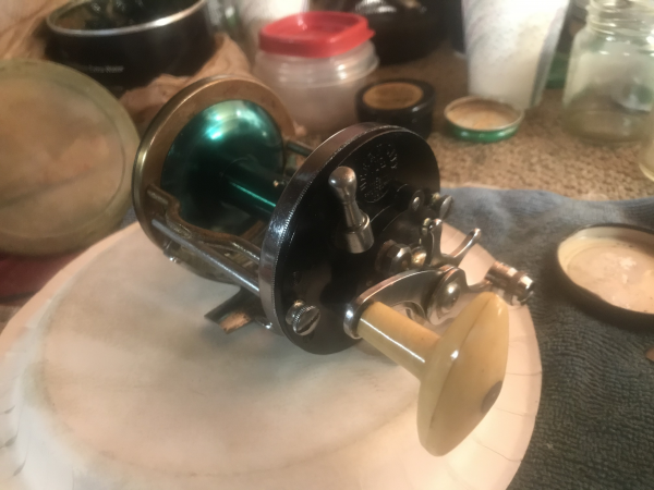

Ok, I'll bite.  Inherited 2 (maybe 3) OC's - a 107, 993 and 1500/20 (??). I do mostly saltwater, so the last one is destined for the bookshelf or maybe for teaching the grandkids.
Thanks to you all, I dove into the 107 and 993 to get them cleaned up.
The 993 was no problem, just replaced the drag washers (only 2) with HT-100's & Cal's tan. (old on bottom; nu on top in pic)
The 107 was a bit messier - replaced the single thick drag and brass keyed washer sitting on top of the gear (middle pic) with 2 HT-100's and thinner keyed washers. Cleaned & kept the under gear washer. Got it back together, but at tighter star settings drag is slipping some and the retrieve binds. Could it be a spacing (3-stack maybe?) or washer/combo issue? It only has a single spring washer under the star where schematic shows another on top.  My bigger problem was no AR dog to be found (bottom pic). I tried some Penn replacements but their mounting holes are all too small for the bridge screw.  A dog without a tab on the butt end (for a JM?) looks like the most promising.
Suggestions?

below is a pic of the AR dog on the 993
#35
Check how the dog meshes with the under-gear ratchet.

Thanks Steve. Looking for a replacement dog for my 107 if anyone can point me right direction. These green anodized spoils are growing on me!

Sciaenops, you can have the dog in the photo above if it will work.  I pulled it out of a bag of loose parts that came with a reel.  The spring (on the other side of the bridge plate) is buggered up but still works.  PM your address.

the closest one I had was the 1/2" one in the pic, but mounting hole was just too small.
Keith
I'm going to send you the whole bridge with sleeve and gear.  The dog doesn't pivot on the bridge screw like in a Penn.  It pivots on its own post pressed into the bridge.

QuoteI'm going to send you the whole bridge with sleeve and gear.  The dog doesn't pivot on the bridge screw like in a Penn.  It pivots on its own post pressed into the bridge.
Cool, thnx, didn't see any evidence of a dog spring/post on backside of my bridge, but I'll give it a shot.
