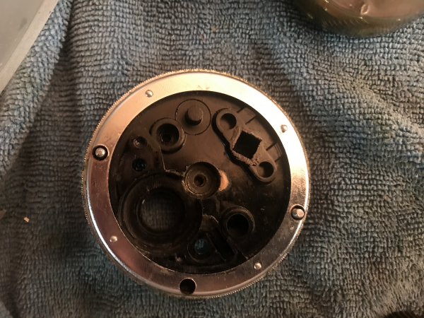

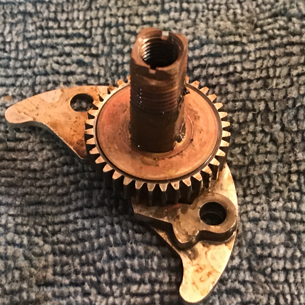

Does that dimple on the bridge plate at about five o'clock in your photo have a post on the other side?  I'm going to send it but am not optimistic about it working without doing brain surgery.  I don't have a 107 but do have an Inductor and a 935.  All are wide-spool 250 yard size.  They both have a bridge and dog like the one in my photo but yours is different.
sciaenops
There are 2 nubs on the other side of the bridge (see pic) which look to have formed matching grooves in side plate. Believe dog/spring setup on this one (107) is similar to my 993 (pictured). Bridge mounting holes are tapped (no retaining nuts like the 993) and shape is a bit different than yours too.

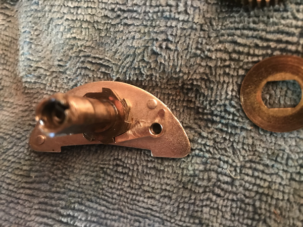

I found parts on eBay for my OC 107 rebuild & scavenged the dog which fit perfectly. I also replaced the thick leather washer with 2 HT-100 (6-60 size I think) and added a thin keyed metal.  Thought I was done but now drive train skips & chatters under load.  Swapped out the main gear & pinion but no change.  When I mate the spool to right side drive train and hang on while cranking, I can rotate the spool backwards (against retrieve direction), so do I have a bad spool?  Something else I'm missing?
sciaenops
QuoteThe spool looks wrong to me  as I think for the gear you have those dogs need to be sticking up not flat like you have there .
I believe you're right.  Seen other spools with raised "block" like tabs.  Will post an ad for one.
Most likly the problem is here with the pinon and sleeve.
A small burr or hang up .   And while it is appart you can chek this fitt.
 Another thing that caught my eye is what way are you putting the yoke plate retainer .   First picture is up side down. second picture is correct.
sciaenops
Got a used spool of eBay, and everything seems to work fine now.  Note the raised block tabs, which obviously made the difference.  Spooled up w/30# but will not push this reel - just local shallow bottom fishing and the 3 "B"s.

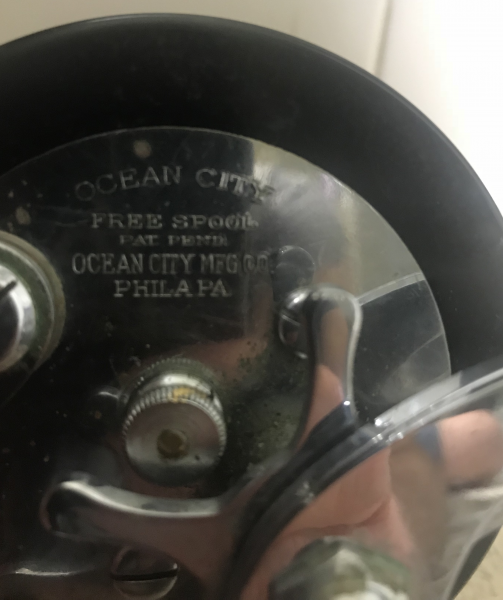

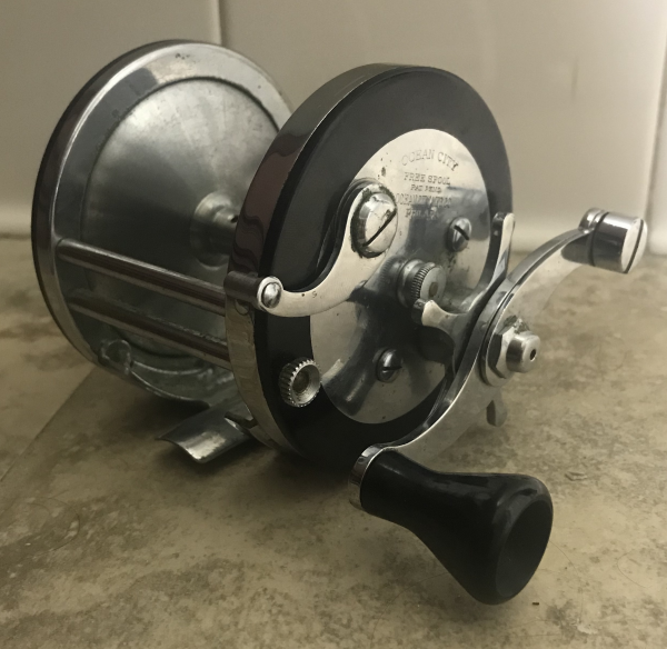

1st time posting, but have really enjoyed reading and learning since finding this site.
I bought my father an OC reel as a Father's Day gift a few years ago, and it looks good in the old OC box on the mantle at my parent's home in Ocean City, NJ.  The reel is the Ocean City 970.  Common reel, lots around, but the really good condition box is what made the piece for my parents.
But, I bought myself an OC reel at the same time, and I haven't been able to find many details or any pictures of this reel.  I bought it because it reminded me of a Penn Senator, and I knew that Otto Henze had worked for Ocean City before founding Penn.  Hoping this group can help me learn more about this reel.
My best guess is that the reel is a used "New" Ocean City reel, #114.  The number 400 is on the reel foot.  The ORCA site doesn't have any pictures of the 400 size reel though, so I am basing my guess on old catalogues.
I'd really like to learn more above it the history of this reel, so all info is welcomed.  Thanks.

It's early.  That handle was only made until about 1935.  It has the then new quick take apart feature.
