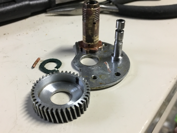

Hello friends, I have an old squidder that has a different bridge post (smaller diameter) and sleeve (see pic) than all the others I've worked on. The sleeve is rounded off and I need a replacement, does anyone know a solution besides stealing a bridge/sleeve out of another one? Thanks, Darin

I have other 155 sleeves including ss ones, that's not the problem, here is my old squidder bridge post on the right and a newer post on the left. The old one is less diameter so all my other sleeves don't fit right. Wondering if someone has an old sleeve that will fit? Has anyone else ran into this problem? Thanks

I had an old 3-99 bridge and a 3-200 bridge with the narrow posts a while back. A newer bridge with a 'standard width' post might be easier to find than a good condition sleeve with the old narrow post bore. I asked a similar question when I 'discovered' mine a few years ago - apparently you can find narrow posts on a few models https://alantani.com/index.php?topic=19995.0

Thanks Mike, someone is sending me a regular 200 bridge, but this was the info I was looking for ;)

   Yes, I've ran into them on Long Beaches, Squidders, Silver Beach 99s, Baymaster 180s, and Beachmaster 155s. It's almost a roll of the dice when opening a vintage Penn.
