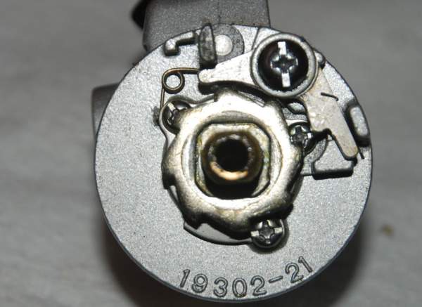

   I've been on the prowl for a lightly used 1600X, but those seem to all be in the hands of happy owners, with no intention to sell. In the meantime, I came across this moderately used 1300X for $17, so I pounced. After tearing it down, and studying the 1600X and 1300X schematics again, I'm very happy I pounced. ;D
   This smaller 1300X shares many parts with it's big brother. It uses the same main shaft, same pinion and drive gear, same large AR components, same large drags, and even the same spool metal. I know...I know...what the heck is the "spool metal"? Some manufacturers call it a spool sleeve, some say spool shaft, even spool spindle...but come on Daiwa...spool metal?? Man, that's weak! This is why I wish manufacturers could stick to a common terminology. :-\
   At any rate, this first pic demonstrates how to perform the "eBay Quick Lube". Just pop off the side plate and pour in some oil, any oil, right over the several dry greases already in there. The second photo shows this previous owner even expanded his magic to the drag stack...another whole can of 3-In-One...I almost forgot to get the pic before I had them cleaned up. Also note the "spool metal" is nicely chromed and the metal drag washers have no corrosion. Sorry I growled about all the oil. ::)
   The AR assembly looks absolutely huge in the third photo, probably because it is. This build style allows that big 3-stack drag to properly play a lunker. That over size steel AR claw and ratchet being out front protect the pot metal drive gear. That leaves only user error to ruin your day, i.e.- locking down the drag and "horse crankin". :D
   Last but not least, here's a shot of all the giblets cleaned and prepped. I'd like to add that Penn #6-155 HT-100s are a drop in upgrade...a perfect fit. This is another one of those reels that is very hard to pick on. Makes me want that 1600X even more. 8)

I have several of the smaller 1000X reels and they are some of my favorites. It was pretty easy to change a couple of parts out and get a silent anti-reverse setup. Looks like you may be able to do the same with the 1300X as well. The parts were still available!
I did put a short video together about that and swapping the bushings out for bearings:
That is one of my earlier videos and not very good (more of a slide show really) but it is what it is! I've learned a lot about the video side if things since then.
The D series was mentioned above. It is pretty much the same reel. I own several of the 1000X and D1000 reels and in all examples I have, the X series came with a clicker anti-reverse and the D series were silent. Same basic setup for the AR but there was a stamped steel plate that fits the dog and a spring that hooks into it that rides a groove in the AR gear on the end of the pinion. I changed out the pawl retainer screw as well to the newer style.
There is something about the size and weight of the 1000X (or the D1000) that just feels right in my hand and works perfectly for the type of fishing I enjoy (ultralight on small creeks and kayak fishing). Rugged little reels and built very well for what they are.
