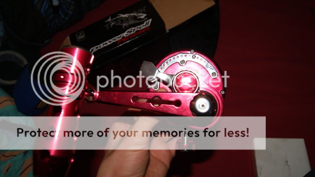

VERY nice Sal. I am amazed. I have one Idea for you dough. How about a red t bar handle. Accurate have some t bars in red and the Jigging master handle, would make it bad ####.

Quote from: hafnor on December 17, 2011, 02:11:15 AM
jm handle
Thanks for the tip hafnor, that t bar looks great but it's just too rich for my blood.
I thought that my hadle fit the reel nicely, the stainless steel handle goes nicely with the stainless steel rings and the black knob  picks up the black spool. The complete handle cost me less than $40, the knob that you're showing  costs around $75 alone. The handle that I'm showing can take a lot more abuse than the aluminum handle, that is why I like them much better.
I know what you mean about matching color, I have done a few reels in the past , but again I wouldn't compare them with the one that I have on my little tank ;).
Here are a couple of shots of matching handles that I've done in the past...

hafnor
WOW, I see you got your game right! that first red handle there looks awesome... Where do you find these products?
#67
Hafnor, I purchased these handles a couple of years ago. The name of the company was K.O. Kustomz ( as you can see on the handle ). I haven't seen any activities from him for a while now :-\. What cought my eyes on these handles was the way that he recessed the handle at the mounting area... makes the handle screw look almost flush with the handle itself, you can see it on the red handle. It's a shame I haven't see him around anymore, he was a great guy to deal with and always gave me a break on multiple handles.
Here are the few that I kept for myself:
Hey Sal,
      K.O. Customz is still in business (at least he was 1 1/2 yrs ago.)  I have 4 handles from them.  They are awesome!  I also like how the handle screw sits almost flush.  The stainless is more functional and durable, however those KO's trick out a Penn something hot.
