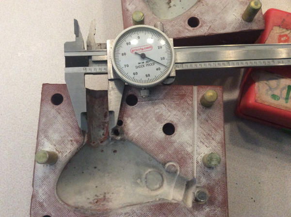

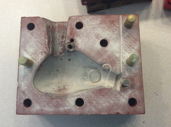

Dave designed and make this octopus jig head mold!!  TO me... amazing!!!!
and here is the final product!!!

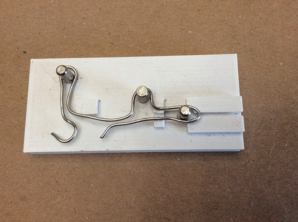

Through some trial & error, Dave custom made this wire insert.

Very Cool. Were positive molds made with the printer then the negatives with some other medium (the red material) to pour the led into. I assume the heads are lead inquiring minds would like to know.
Thanks Wayno.  It was a pleasure having you here Gary.  Dominick
Cool stuff! Looks like you were really concentrating Gary.
I'm glad you had a good time.

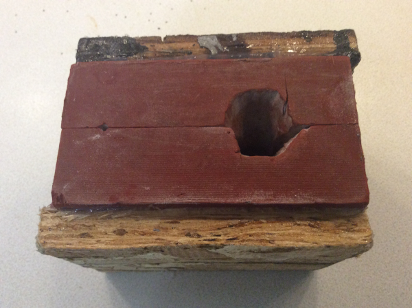

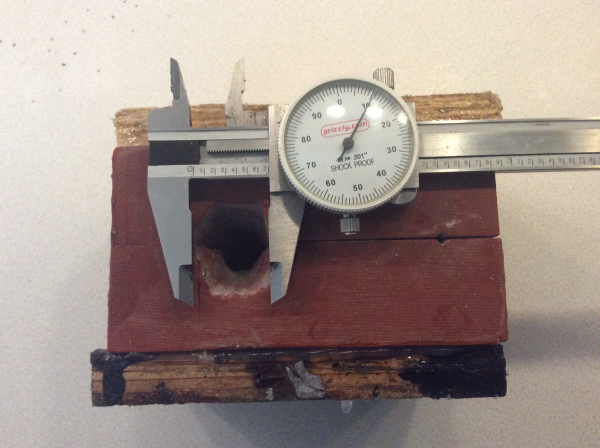

Yes, mr rocket dog, the master was a design of Dave's, and made in the 3 d printer that he put together.
   Then a mold was made of his best experience of a silicone for the size of jig.  How that was done you got to pry Dave.  The pins that lock each half are square and equal in height so I,m assuming the computer 💻 was used in the mold.

The wire is bent in a bending jig that is alo 3D printed.  If I bend freehand, my wire work is too "artistic" (each one comes out different, and most do not fit in the mold :) )
I think the answer is yes if the question is inverted.  I call them mold masters, but that is inaccurate.  I am printing the mold negatives, or molds for the molds.  I started out like everybody else, printing a master of my part, burying it halfway in modeling clay, pouring the first half of the mold, removing the clay, yada, yada.  Eventually the lightbulb turned on, and I realized that I could use the software to generate negatives for both halves of the mold instead of doing it by hand with the master and some clay.  Much faster, and I can pour  a replacement mold whenever I need one.  The 3D printed negatives are so accurate and fit together so perfectly that there is no flash and very little visible seam.  Of course, later on I discovered that I was far from the the first person to figure this method out :)
One of the  tricky things when applying new technology is figuring out how to take full advantage of it, and just not use it for a few shortcuts to make the same parts the same way.
And to some extent, this is only worth it if you you are trying to design something new with specific characteristics  and need to go through several iterations to get it right.   Just taking an existing lure and manually making a mold is much simpler if you just want to copy something that already exists.

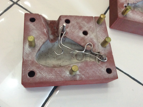

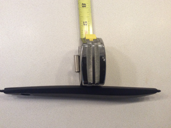

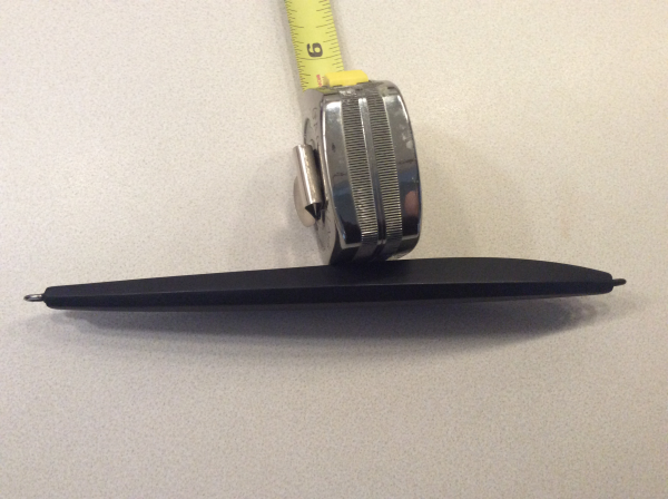

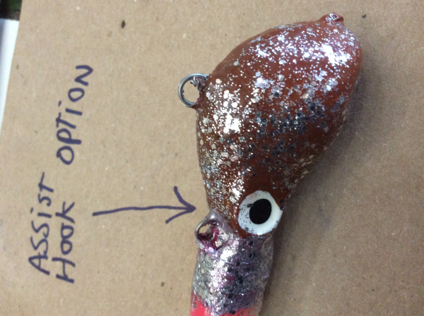

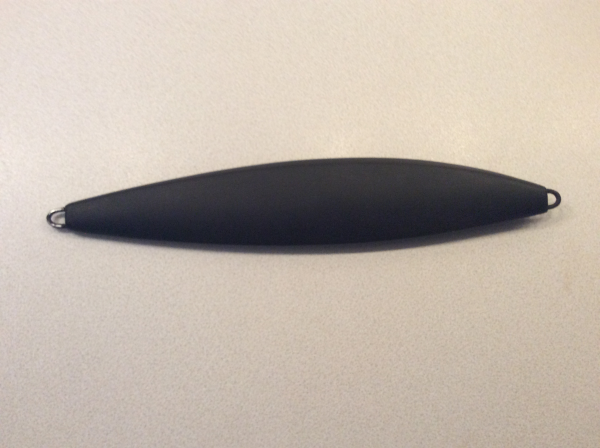

Thanks Dave ,  I was drowning in a see of technology!👌.   You mid water flat fall jigs were even more amazing 😉.  One side is oval, other side flat angles for spin, wobble in decent I assumed?
  I've yet to make a mold for it.  Butt shown below is a Dave's original.
I,m guess ing this would be a 8-9 oz persuasive in lead.  Here's where powder coating would be nice.
    This jig makes the octopus 🐙 one a clunker, butt it's a bottom fish jig spectacular.
The wirebend jig is useful in connecting the 3 eyes and can be bent up in your spare time.

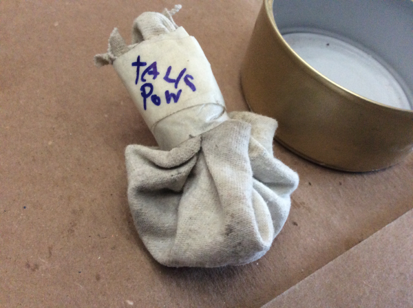

     Using a talc sock, is an idea he advised for the release agent.
Here's what is amazing 😉.  This mold was made in the mind, not by human hands.
