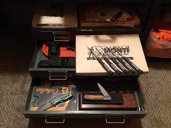

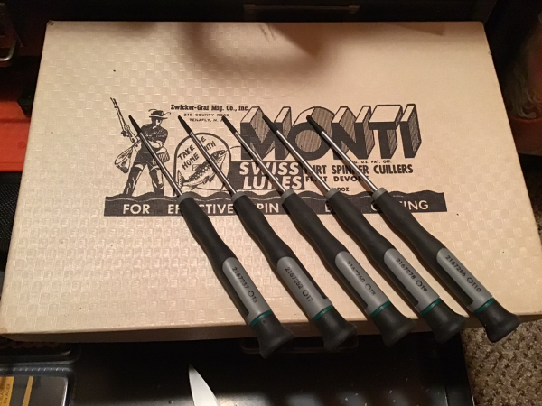

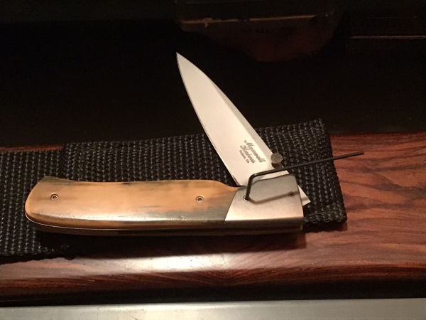

Camera supply companies, optic supply companies, hobby shops, RC shops.
I occasionally do a little knife making -- some of the folders use either tiny hex key inset screws -- Or tiny star torx screws.
I picked up a set of the tiny Torx drivers from the local Ace Hardware.
https://www.edmundoptics.com/p/09mm-hex-key-size-metric-allen-wrench/15480/
