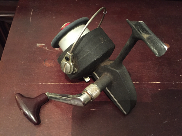

How are you guys replicating the Black Crinkle finish on your restores?  I've got another project coming up (someday) and was wondering how to get a similar finish.
I use VHT Black Flat Wrinkle spray paint --
Clean the parts to be painted
Sand down any loose paint
Blow it off
Apply the paint after taping off areas that should not be painted
Bake in the paint oven for 25 minutes at 200 degrees
Let the parts set for 30 minutes after removing from the oven
Assemble the reel
