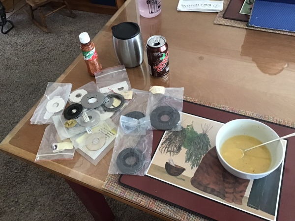

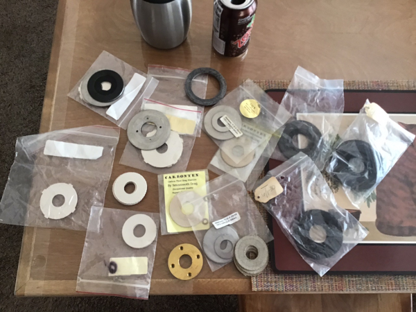

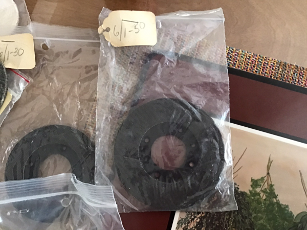

Not sure if this will help, or not --
But here is a loose NOS Carbon Fiber with the back-up plate.
Recently stopped working on conventionals a couple of months ago, after 40+ years.  Sold all the parts.  These were just loose larger drags in a drawer.
Doing mostly only vintage spinners now.  And busier than ever.  Backlog is approaching 85 units to hit the bench on just spinners.  Am working on them daily -- since there are a lot more on their way.
                                    — William Faulkner
boatboy319
Hi Fred, that looks like exactly what I'm looking for.
Sending you a PM if you're interested in selling.
I have no use for it -- probably had it for 20+ years --  it is yours if you think it will work for you --
List is $66+.
Figure $30 + $5 shipping.
Will need your mailing address and contact info.
Just send me a PM -- and I will send it out Monday.
                                    — William Faulkner
