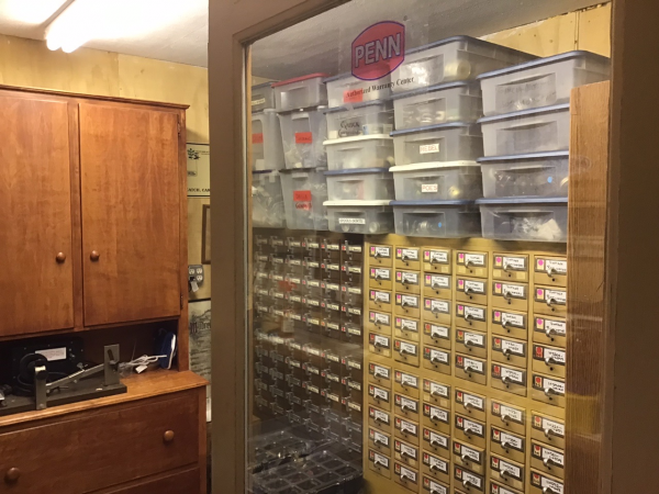

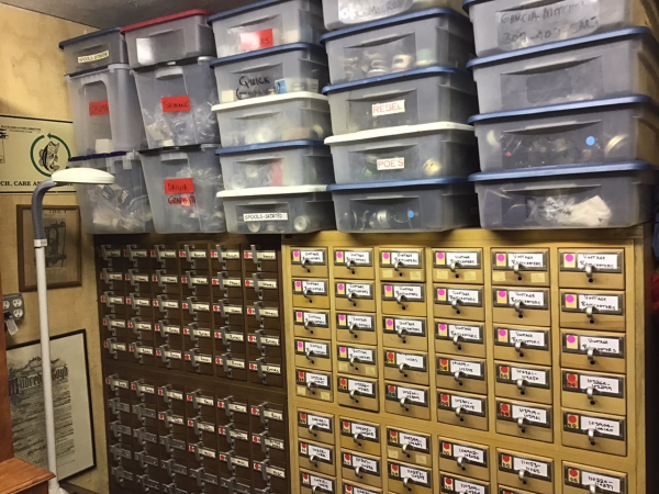

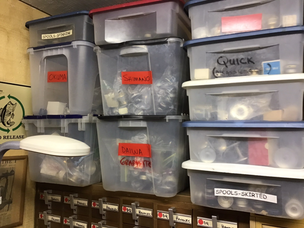

If you can post a photo of your spool and reel — I might have a new spool in one of the Daiwa spool bins.
Can't promise until I can do a match — but it would only be a few bucks, if I have one.
Probably have around 1000 to 1500 to spinner spools — not counting 1000 to 1200 DAM Quick, Penn, ABU/Zebco, and Mitchell— which I will keep for restorations and repairs.
These Daiwas, Shimanos, Ryobis, Shakes, and many others — likely need to go bye-bye, dirt cheap, real soon.
Don't want to store them any longer.
