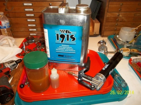

I have used many oils for reels over the last 40+ years of servicing tackle -- the best I have found is a product called WRL 191S.
Few people know about this product outside of the industries who use it by the 55 gallon drums.
It is an industrial grade oil used primarily for a steel cable lubricant where moisture and water is an issue.
WRL -- Wire Rope Lubricant
A gallon lasts me about 3 years -- and I am on my fourth gallon since I started using it.
It is slightly thicker and milkier than normal reel oil, synthetic, water and salt water resistant, able to hold up to extreme temps, and will not get gummy or set up after a few years of non-use.  I use it with a micro needle bottle.  Non-Petroleum, biodegradable, safe, non-flammable.
A gallon is between $47.00 to $85.00 -- depending on where you get it from.
It is used extensively in the railroad industry, emergency services, military, as well as being tested by NASA for their use (it has supposedly passed 2 of the 3 major tests to be put to use full time by NASA).
I have used it exclusively on thousands of reel jobs -- springs, level winds, handles, knobs, any exterior moving parts, some interior where grease is not a good idea, shafts, spools, and sometimes bearings.
I have nothing to do with the company -- just wanted to share.
It just works very well.
