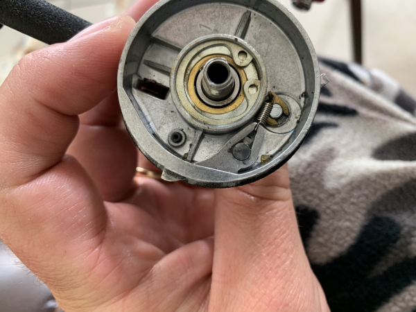

Need some help figuring out what I am missing. Bought 110n and seviced. The bail is not tripping. The mechanisms associated with pin cleaned and oiled. This first 110n serviced. Couple things noticed the dog spring has light tension, the bail itself feels like has a lot of tension, or am I missing part (see pic below). I rolled over by hand and not tripping. Does anyone have the top washer spring on drag.

The tension on the triangle spring can be adjusted to (3) different spring pressures.  It is easily adjustable when the spool is removed.
But that is just an adjustment — likely not your issue.
Since your bail spring is strong — I would look into the trip mechanism —which is mostly under the rotor.
It consists of a switch block, activation rod, small coil spring, super tiny "c" clip, a tiny rubber brake ring, the triangle spring, the setting control.
Typically, this mechanism is gummed up, corroded, stuck — or the most common cause — the tiny rubber brake ring has degraded, come off, or is missing.  The brake ring is necessary to trip the bail tothe closed position.  The tolerance is exact — and this tiny piece is critical to the proper bail operation.

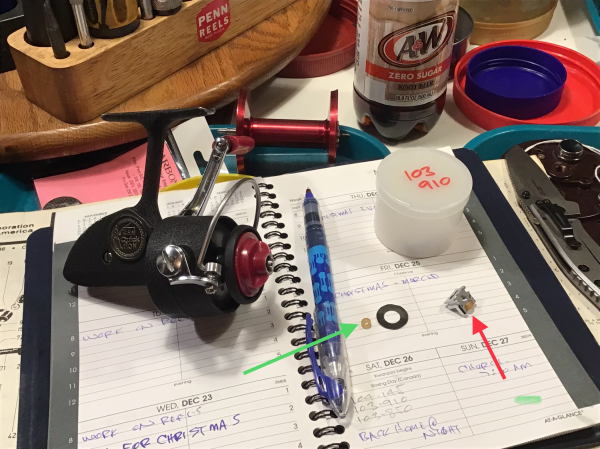

If this is what you need, James —
It is ready to go out to you.
If the little rubber tan ring indicated by the green arrow — is missing from the switch block where it goes on — indicated by the red arrow — that will be your culprit.
If it is something else — let me know — and we will figure it out.

Thank you the two pieces beside green arrow are the ones I need. I decided to just use the 330 for a parts reel. Thanks you again for everything. Send you pm

The reel is running like a charm, thanks to Fred.
Nice work, James —
Your 110N Microlite looks great.  Funny, how one little tiny seemingly insignificant part (hidden internal bail bumper) can make all of the difference on these DQ reels.
