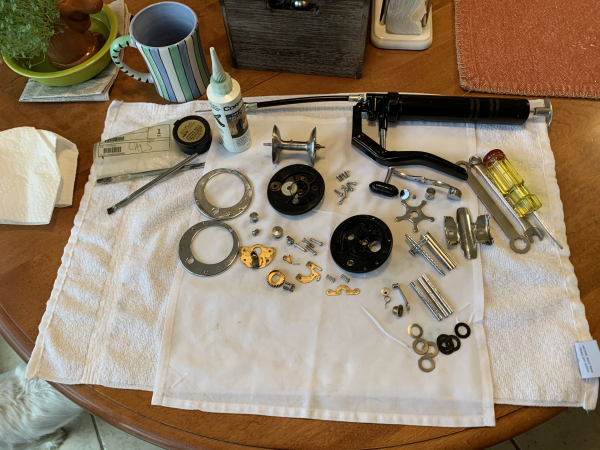

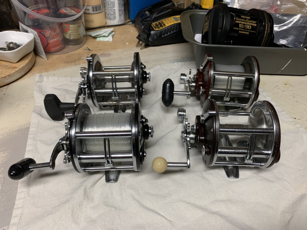

I've been collecting a few 209s to add to the rods for the kids in my family to use.   My nephews have a gaggle of children that I'm fortunate to get to take fishing (just like I took them). I wanted something they could use to catch catfish here in TN or take to the ocean pier.  I picked up a few 209s for their simplicity of use and ease of maintenance. I then cleaned and gave them the "Tani Treatment".  They're like new and ready to go!
Mike   Memphis TN
Mike Grosman
Great work, Mike —
Those are looking very good — inside & outside!
Good job !...on the reels, as well as taking the kids out, to use them !
Great call on your intended purpose. Few freshwater fish and few pier fish are going to stretch those out with 25lb mono on them, and you can find them for 30 bucks regularly. 5 bucks worth of drags and a service, and for my money there isn't a reel around you can buy new for 30 bucks that will outlive / work what you just built. The Peer LW's don't get a lot of attention, maybe because they just pack a lunch and come to work every day. I have  a load of them- the 9's and Mag 10's will be leaving the dock for live baiting stripers here shortly, I use the 209 and 210 for downrigger reels (also great for Spanish Mac trolling) and 309's for lead core trolling. I will wager cash the 309 has caught more lead core stripers on my lake than all others combined.
Nice job on those!
   I grew up with 209s...poor kids on the river never even seen a Senator. A well serviced 209 will last forever, and is a very capable tool. Nice work! 8)
Hey,  just noticed the 12/20! I bet the redsetta says, "what 209's???? (Justin) :)
