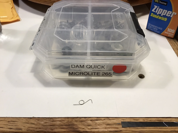

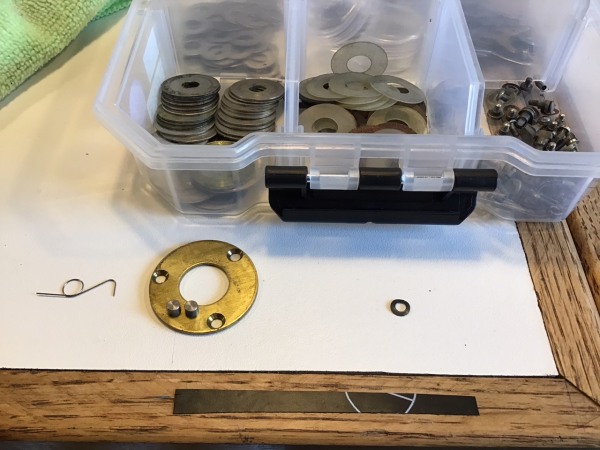

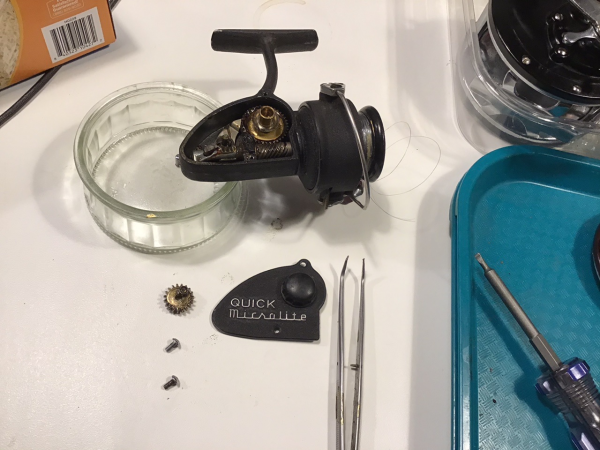

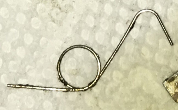

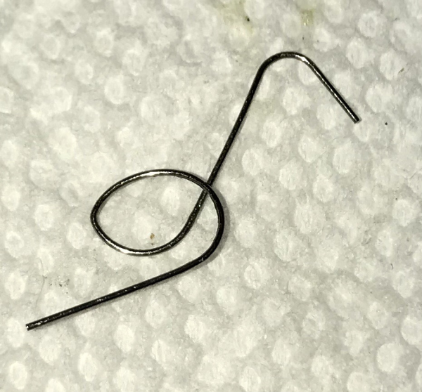

Reassembling the AR parts in the wrong order and
tried to force things. The spring didn't survive.
Lesson learned. Before and after.
Here is one that I will send you, Steve — N/C.
I still need your parts list we talked about a few days ago —
sandbar
I was working on it tonight Fred. I'll add the spring and email it to you tomorrow.

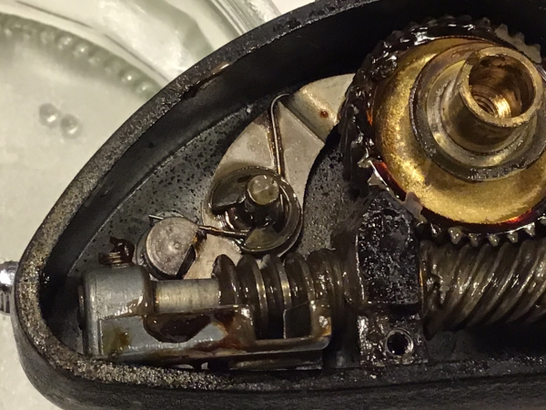

The eccentric goes in first, correct?
Quote from: sandbar on January 09, 2021, 01:49:18 AM
Yes, Steve —
Eccentric goes in first — then the A/R dog, spring, "C" clip, copper washer, worm wheel gear — don't forget the roller for the oscillation guide that goes on the worm wheel nub.  They fall off easily during assembly.
There is a tiny groove on the eccentric where the tail-end of the A/R spring rides.
These tiny little 265 Microlites from 1960 are the exact same design and parts as the toughest salt water DAM Quick — the old green giant 270 Super — just 1/4 the size and weight.  Amazing engineering!  Possibly my favorite tiny DQ.  Metal spool.

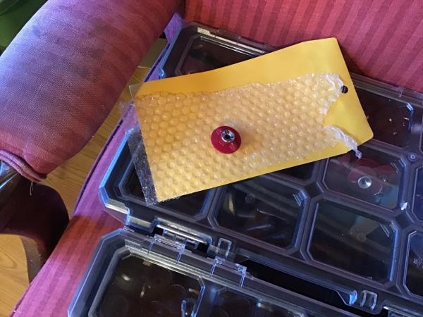

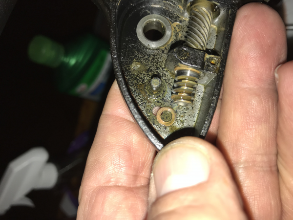

When I took this apart there was a copper washer under the eccentric, between it and the housing, and
then a spring washer and lever on the outside of the housing. There was no copper washer under the wheel that rides on the AR lever pin.

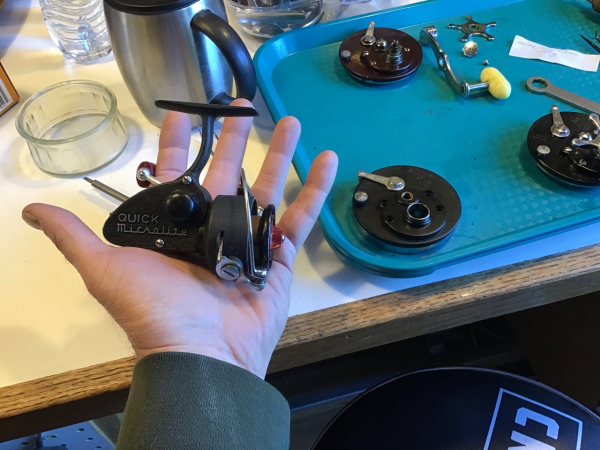

Here are a few more thoughts about the rock steady tiny D-A-M Quick 265 Microlite —
8 ounces — fits in the palm of your hand
Same materials and dead-simple engineering as the largest DQ's — aircraft grade precisely-formed frame, plate, rotor
Metal (aluminum) spool that holds 110 yards of 4 pound mono
Handle folds for transport and storage, bail folds flat to relieve pressure on the bail spring
While still very lightweight at 8 oz. — it could have been engineered with plastics, composites, lighter metals, thinner components, less reinforcement, less exact tolerances, etc — but this was made by a company and mindset that would not allow those methods.  The DQ reels were designed to outlast an angler's lifetime — and be passed on to a son for another lifetime of memories
Most folks do not know that there were (2) versions of this little 1961 powerhouse Microlite — early and later
The differences are slight — the main caution being the fact that the rotor and worm drive in these two versions were different — the threads were left-hand in one, and right hand in the other.  This can cause serious issues for a reel mechanic who is not aware of the differences.  Also, there is a different A/R lever — along with different washer configurations — or lack of washers in certain areas.  No big deal — all will work together — except trying to thread an aluminum rotor onto an opposite threaded worm pinion.
These are high speed reels at 1:5 gear ratios
The worm pinion also operates the worm oscillation gear — which exactly lets the spool oscillate independently — without any additional lateral stress on drive parts
The main bearing is all steel, over-sized, and of a high quality
The main gear support bearings (bushing type) support BOTH sides of the main gear — in an exactly center balance design — no side torque — no early wearing out or degradation
The worm pinion is solidly supported by the main bearing — as well as an additional bushing near the rear of the frame
Steel, bronze, aluminum — all in a tiny package.
Handle assembly easily switches to left or right side.
If these reels were produced today — using the exact same materials and quality — they would likely be in the $250 to $300 range.
This is one of my favorite DQ reels.  Fairly rare because they were expensive in their day — and few folks would come to appreciate the inner workings and capability that made them 2 to 3 times the cost of a Mitchell, or similar reel.

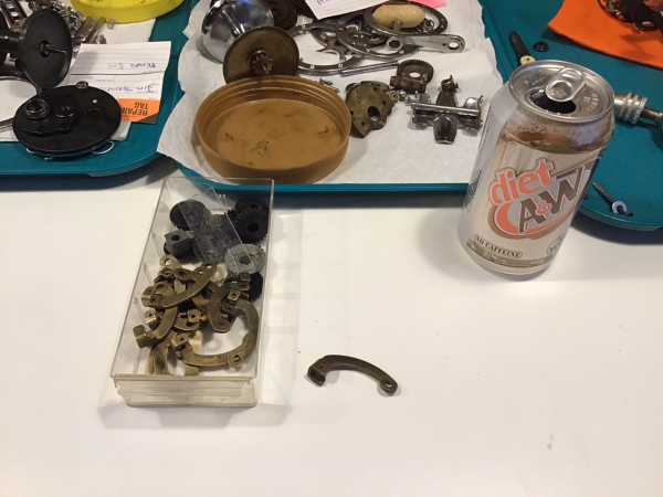

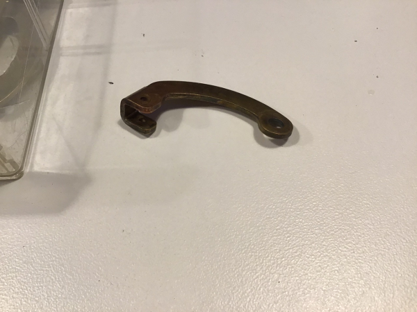

I found a temporary fix for the loseness of the AR cam shaft, in mine, where it passes through the gear box: a tiny strip of aluminium-can wraped around the shaft. That part is tight now, but will it last? Whata you guys think?

Quote from: Gfish on January 09, 2021, 06:09:53 PM
I found a temporary fix for the loseness of the AR cam shaft, in mine, where it passes through the gear box: a tiny strip of aluminium can wraped around the shaft. That part is tight now, but will it last? Whata you guys think?
It'll last for a little while, Greg — or it will last forever if you set it on the shelf.  😄😄😄
However, it will flatten out with use on the water.

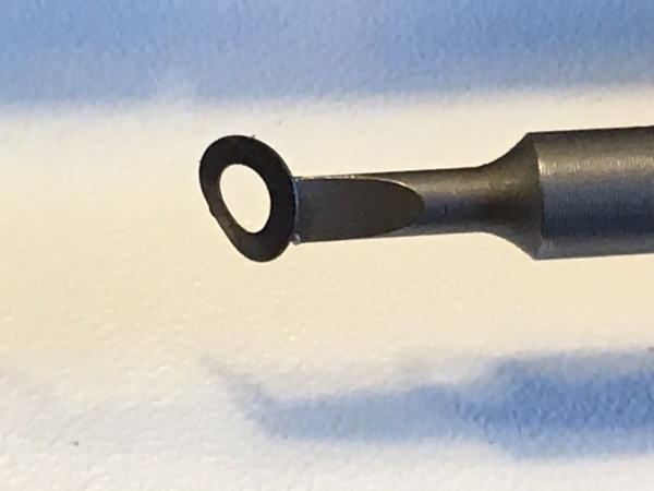

These have a steel spring washer that is the right part for a fix.  Sometimes I just take the spring washer and increase the bend slightly — the spring washer goes between the A/R lever and the reel frame.
