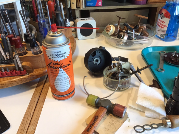

When everything is removed — including the hex nut, and spring washer, and maybe the drive plate (this isn't a deal breaker, the worm will come out with the drive plate in place) — next do this...
Put a big, fat rag under the body and rotor  — as you hold in your hand, just the rotor — as securely as possible — then, using a nylon faced hammer — just drive the worm pinion downward — thus breaking the fuse-hold.
If you don't have a nylon faced hammer like this — a chunk of hardwood can be used as a drive buffer between the top of the worm-pinion and your hammer.
This has ALWAYS worked for me with never an issue —
After you get the rotor off — you can then remove the other parts mentioned — drive the bearing off of the worm-pinion — clean everything up as good as you can.  Test the bearing, replace if necessary.
This will work — no worries...

For tough bearing/worm pinion extractions — this has always worked pretty well for me.
Me, too. Same concept with a little different setup. I usually do it so the body ends up in my lap, on purpose.  :)
