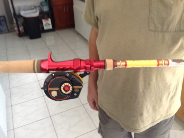

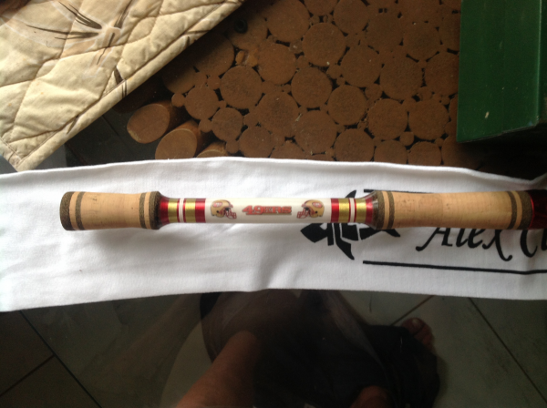

Alex and the SF 49'ers came to mind when I thought about a custom reef baitcasting rod(basically a 2-handed 7' bass rod). He has a way with colors and deacles and I loved what he did for a friend on a LA Rams themed custom rod. So we worked on all my preferences, starting with the blank. He's real detail oriented, with information and opinions/suggestions about every step in the process.
The rod handle, both sides and the seat;
More;
Man I'm so bad at lighting when taking pictures. The 2nd pic. blank stats. say: NORTH FORK SJ706-1 - Fast - Heavy  7ft 0in - 10-17lb - 1/4-1oz

A real nice Alps reel seat, cork handle/butt and the guides(9 + tip-top) are Fuji _ _,the best out of Alex's suggestions, but I deleted that specific model info. Maybe he can chime in here. Yup, there's some grass on the guides(last pictures from above post) from practice casting on the lawn at work. Casts 7/8's of an oz.- great! Plenty of fast load and snap-back with this puppy.

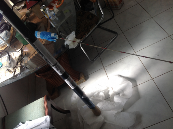

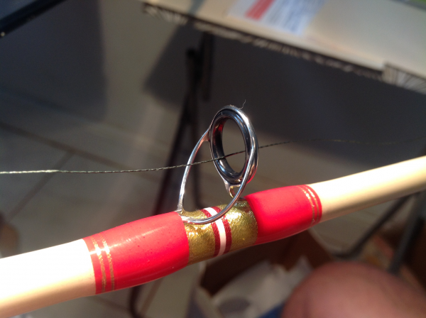

No need to open a new thread so, I will post some pictures of the fishing rod for Gregg before sending it to him.

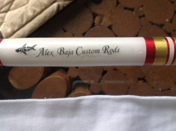

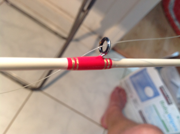

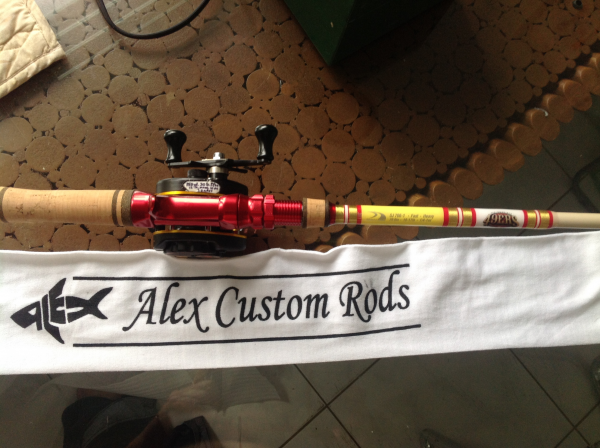

Gregg, wanted good quality components and accesories for this fishing rod, no blig-bling metal inserts and themed with the 49's team, So, we looked some options for blanks and found this NorthFork composite blank he liked it for his needs, the guides used on this build are Fuji LN Alconite guides double foot for the 1st 5 guides and LN single foot for the rest 4 guides to the tip (just to keep the last section of the rod light and sensitive), the tiptop is Fuji Sic, the Reel seat is an ALPS aluminium Triggerseat which is perfect for this rod, high grade cork grips and the guides were wrapped with 49's colors.
the blank have the last 1/3 or almost last 1/4 really really flexible and sensitive, in that zone its so flexible that when checking the line on the static test I had to re-arrange the guide train and add another single foot guide until having a smooth line transition all the way the blank, after that sensitive zone of the blank it becomes a bit more stiff but in a smooth gradual way to the rest of the blank, I really liked this blank, no wonder why Shimano bought G-Loomis rods brand, after that Gary Loomis started Northfork composites blanks.
