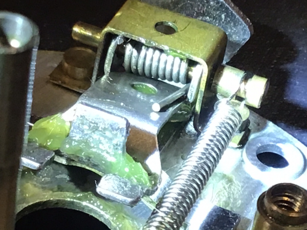

Wompus Cat
Here are a few photos of the area you need to focus on .

Thanks for the reply and great pictures.
I understand where all the parts go.
I am having a hard time of installing the changing spring.

#11
Yes, those HD springs can be tough — until you have done a couple —
Henry (WC) has it right — but here is a procedure that might help you —
Because it needs to be loaded in a "pressure orientation" — and those springs are strong.
Just force the spring under pressure — beneath and between the brass holding mount on the mounting plate & the pinion lever.
Line up the holes on the left side with a pick or small rod to hold everything in place — feed the bearing pin into the right side and through the spring & holding mount as you remove the alignment pick tool from the left side — that's it!
The bearing pin needs no keeper — the long tension spring holds it in place.
Orientation is the long leg of the spring is on the bottom right — flat against the pinion lever — the short leg is on the upper left — just under the holding mount.

old 1946
Thanks for all the replies I knew I came the
right place.
First try with the drill bit did the trick
smooth as silk.
Again thank you all for the advice.
