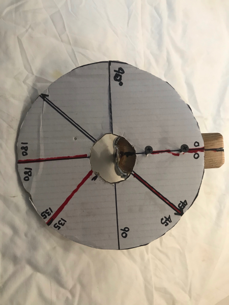

It seems like this is A place to start when laying out the guides for the transition.
   Here's what I came up with,   Easy,  low cost, reusable, handy.

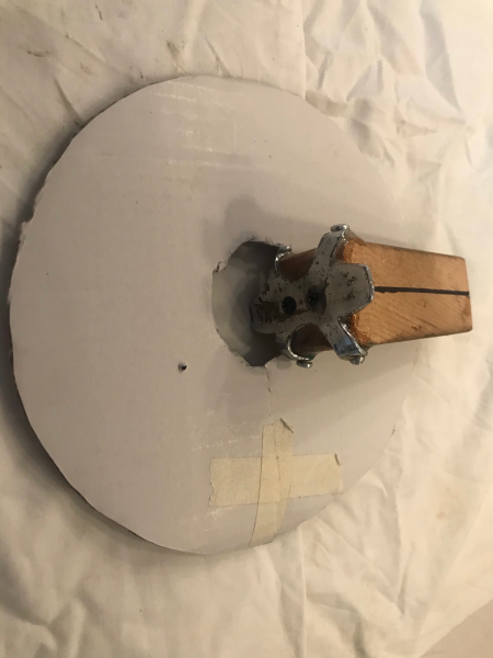

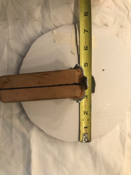

The scrapbox of reel parts had a stand that caught me eye 👁.   A scrap of cedar would be easy to shape.
    Epoxy is everyone's friend.  A screw or two.
The shiny plate fits in the reel seat.  After locating the top, vertical,    Make a wire pointer and adjust to this mark.   Zero.
   The other marks  are giving you a visual and can be adjusted as desired.   In this case I,m using the red marks for my transition.    Try it,  you'll like it.

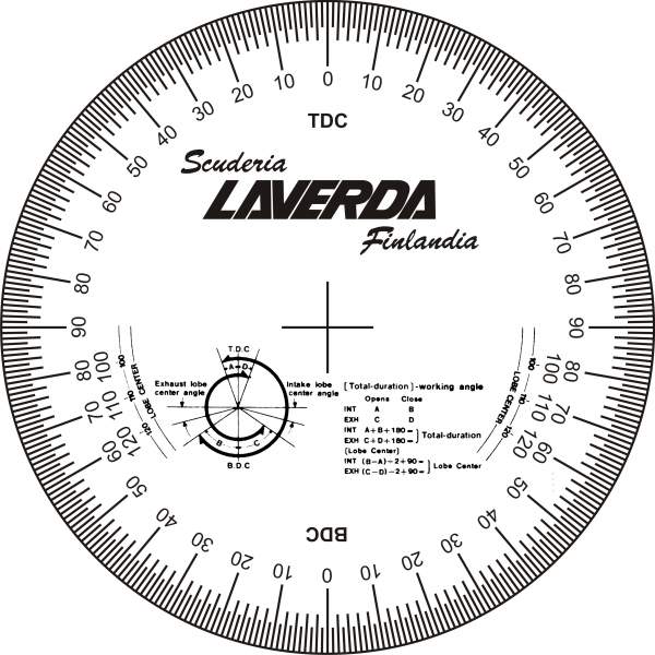

            ???        That`s a degree wheel for setting cam shafts  , Are we going to start measuring the over lap between the stripper and the bumper guides . ::)
           That is a good size to print out for fishing rods
Tanks for your interest in overhead valve engines.   I cant seem to find the link to the printable pdf.   butt its here somewhere on this site as we have talked about it before.   if you fire the engine before top dead center the magneto must be adjusted accordingly......gst :D

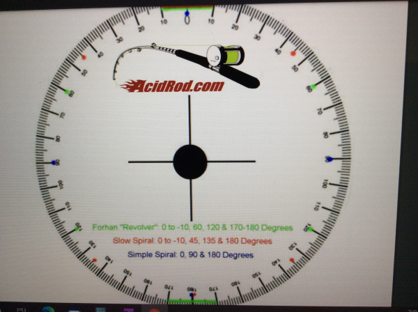

Instructions for use - Acidrod.com  has a degree wheel layout and some info,  to acess a PDF search in Degree wheel on home page.
  I,m not very good on computer stuff,   butt you can findit there.   Its printable and might help?
You can copy this or print your own,  just saying.✍️🎣
