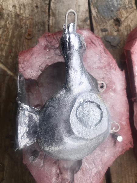

As sitting around makes me uneasy, I decided to be a man and pour some lead.
   Late last year I was gifted a few finished jigs with a silicone mold from Dave.

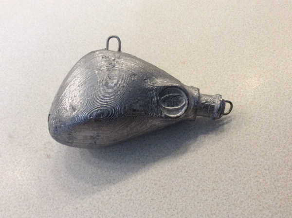

You know, the mad scientist 🥼.   The photo even shows you the clue that this master was 3D printed,
   I poured several of these and they turned out very clean and easy to make.
           Thanks again Dave.🐟.         More soon.

Thanks for the update Gary.
We are pushing the limit size-wise for pouring lead into silicone molds.  Glad to hear that is working so far.   Let me know how long it holds up.
Was it the red or the blue silicone on this mold?
-J.

Reply to Dave.   Your mold was the white/beige silicone material.  It even smelled different after filling.
   Can you tell us the product name?   From Smooth On?
The original creation in the red Max 60 mold is one that was tried in a plaster mold before you helped me with the silicone materials that you have used.   This one is 19 oz and for deep water exploration.....
    Thanks again.   More soon. :)
My pattern is made from plaster o Paris,  crude, rude and socially unacceptable.😸🙋‍♂️🎣
jurelometer
The light blue stuff is made by Silicones Inc.  I bought it from Eager Polymers.   Nice folk.
It is 10x easier to pour than  the  Smooth-On Mold Max 60. It is a slightly lower durometer (50?)
So far I have found that  seems to expand a bit  more when it gets hot, so it is a bit trickier to make exact parts.  I also had to change my through-wire bending jigs to be adjustable to account for expansion.
It scorched a bit on pours, but has held up OK through a couple dozen  flat fall jigs and some  8 oz octos.
If it holds up OK for you 16 oz pours, I am not going back to the Mold-Max.
If you want, I can print you a jumbo master for making plaster molds, but who knows, the fish might like yours better :).  Gobi can decide which would look better on his trailer hitch  :D

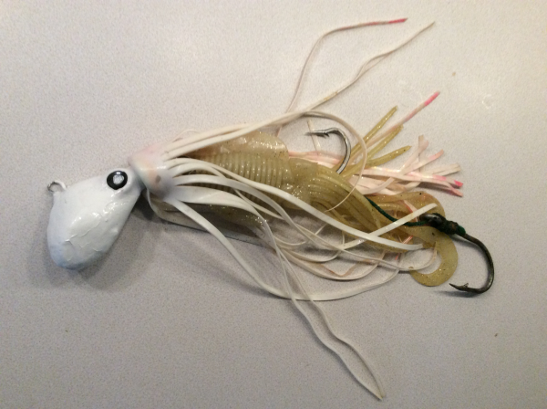

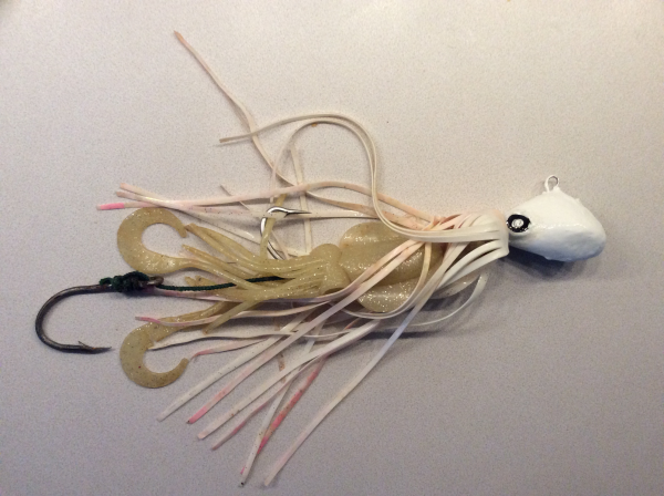

     Below is one of your 3/4 pounders that go new paint 🎨.  Adding the glow squid and the octopus skirt helped naming it,   White Trash..........🎣
