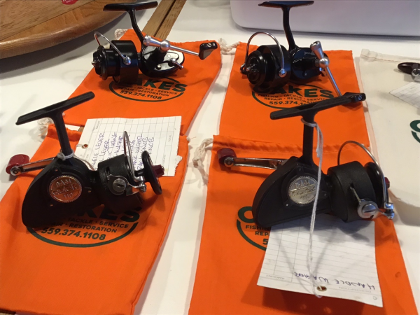

Had a member send in (5) DQ reels that he had purchased used.
(2) 110's, (2) 220's, and a 330.
Needed to use them for himself — as well as guests at the cabin.
Typical of these is dried up 45 year old grease, bent parts, worn pieces, paint worn off, and other normal issues.

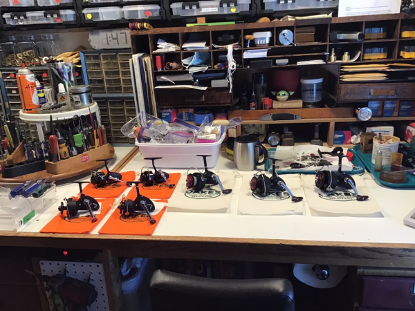

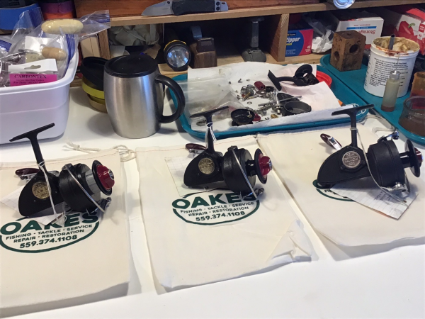

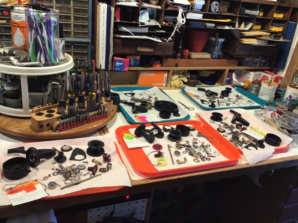

Each got a full disassembly, inspection, Ultra-Sonic Cleaning using (3) types of cleaners, rinsing, drying, re-inspection of parts, burnishing of all interior and exterior parts, replacement of any worn or broken parts, painting the exteriors, reassembly, lube, tune, adjust, and micro-adjust all functions.

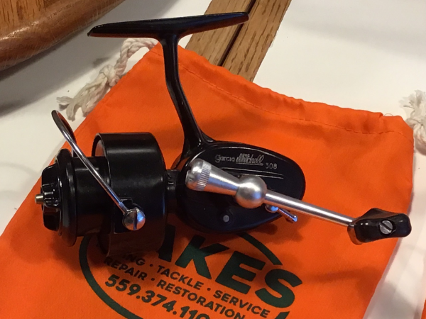

This member also wanted a couple of Mitchell ultra-lite 308's — so I built those from as many new parts as possible out of the bins.
All (7) reels are as smooth as sewing machines — and should last another 40 years, if serviced every few seasons.
Ready to ship out.
