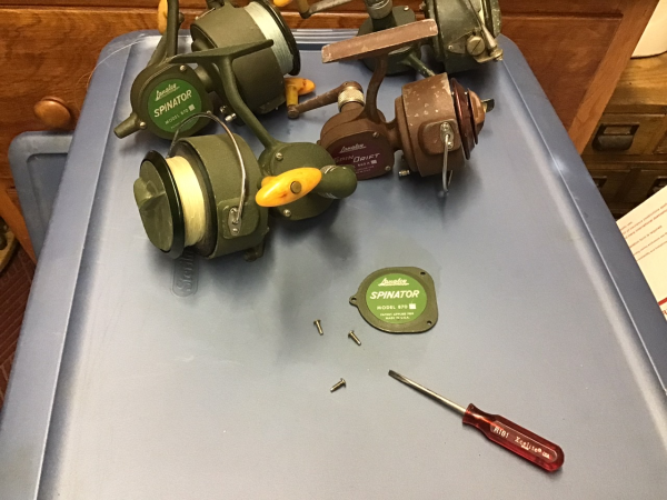

It would appear, at first glance, that it would be a simple process to switch the sideplates, handle, and reverse the crosswind block — although the glued label would also need to be removed and re-glued 180 degrees.
But, if memory serves — there is a factory conversion kit to accomplish this.  So I think it may be more complicated than at first glance.
To eliminate my confusion — do you want to end up with the crank on the left or right side?
(A right-handed reel has the crank on the left side — a left-handed reel has the crank on the right side).
I generally just ask folks where they want the crank to be when converted — left or right side of reel.
     Just hold on til tomorrow

Thanks for tearing into one just to answer my question, Fred.
You da man!     ;)

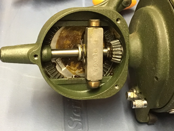

Well Let me modify my post .
Like the all knowing Fred says it may need a kit BUT if I recall I think you just need to turn the guide that the Main gear fits into around when you take the Gear assembly out and it should be good to go.
Have not torn into one of those in awhile but seems like it was fairly easy to do .

Typically, what stops the presses on these switch-overs — is not the straightforward switching of sides when possible — it is a different adapter needed for the Anti-Reverse mechanism.
