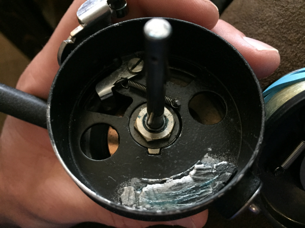

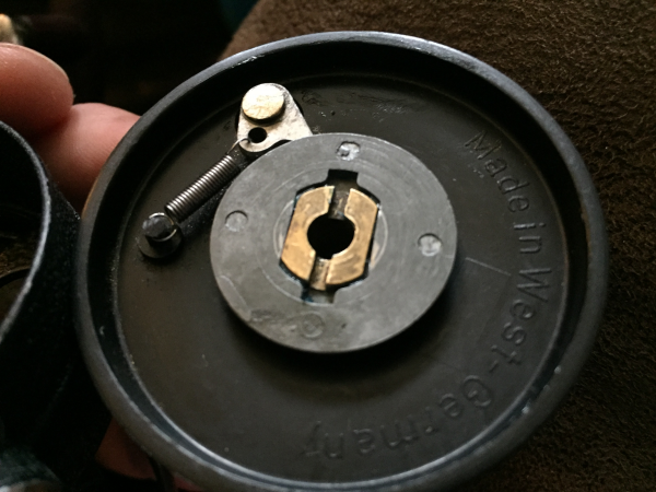

In the earliest DAM Quicks, basically between '50 to '61 — there were serial numbers.
The SW68, Standard 250, 240 & 245 Juniors, 280 & maybe the 285's, some early Super 270's.
Wasn't aware the 265 Microlites had some serial numbers also — Thanks for bringing it to our attention!
That particular Microlite 265 is the earliest first version of (2) — Introduced in 1961.
It is a baby Super 270 — same engineering system, same top quality material selection & interaction, same era.
