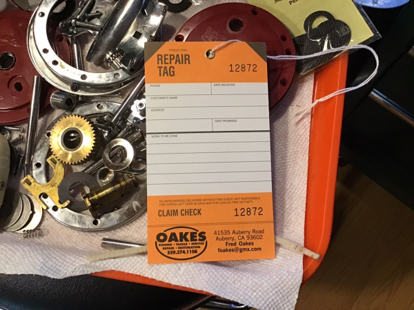

For me, simple & old school works pretty well —
Reel hits the shop
Inspection
Hang Tag
Tray
Clean, service, repair, restore, etc.
Bag
Send back to client

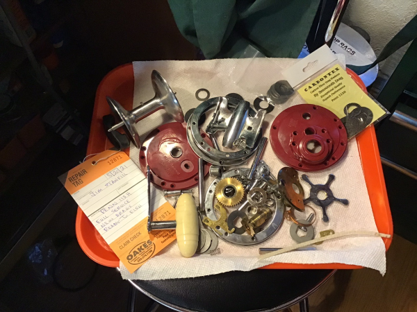

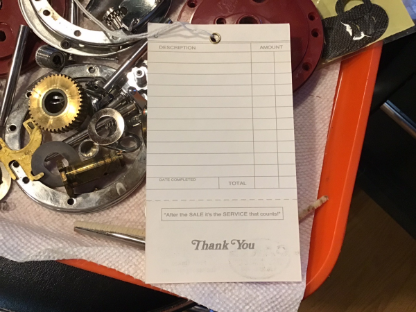

The reel stays on the tray, the hang tag has all the info needed for me —
Client approval, client information, client contact (phone & email), mailing address, issues to address, parts replaced, labor, etc.
There are many details and other aspects to my system — but I try to keep it simple and all in one place.

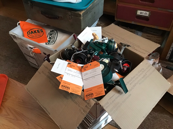

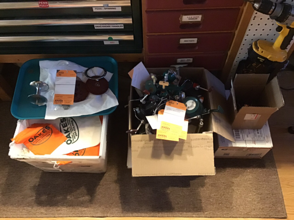

Here is a typical scenario, yesterday —
Client sends in 21 reels for restoration, service, repair —
They get a basic diagnosis, are tagged, and an email is sent back to the client with options and recommendations.  Upon approval — notes are made on the tag — and work proceeds.
Photos are taken of the disassembled reel — and a photo of the tag front and back is also taken for reference.
Payment gets sent after the work is completed, reel sent back, and the client is satisfied.

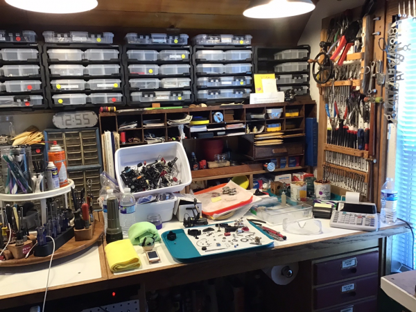

Thanks for the information Fred, love your workshop layout and the use of trays for each reel.
The service tags are a very nice touch, will have to get me some of those.

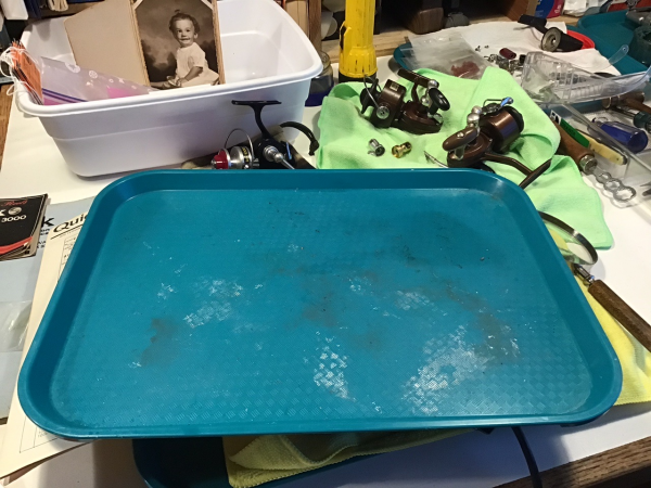

As Fred says, trays if you have space- I use cookie sheets from Dollar General with a lint free cloth on it to help keep springs from bouncing. If I run out of run and I know it will be a bit, after cleaning i will reassemble the large parts of the frame and plates and bag the innards in a small ziploc, then put all in a larger ziploc, labeled until ready to deal with it.
If I need to get a rod on the bench for work I have to clear space.

Like you I have been using a ziploc bag for each reel. I make progress notes on a small card that lives in the bag.
