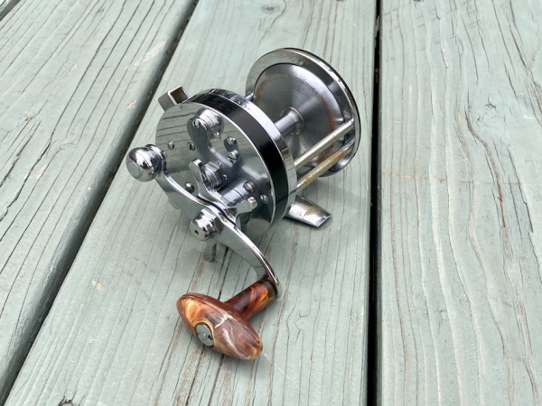

Pflueger Capitol 1985 ("100yrd"). Introduced in 1936 with a long run, to at least 1959. The Capitol reels (3 models: 100, 250, 300yrd) do not have the "Mechanical Thumber" anti-backlash mechanism.

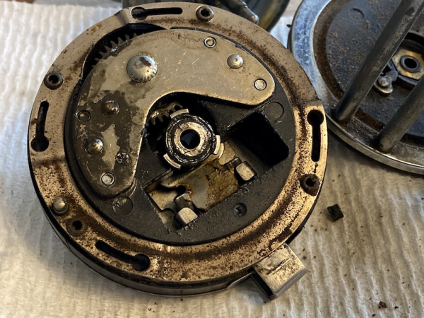

This one came in dirty but cleaned up nicely and is fully functional. Oddly, this is the second Pflueger SW reel that's had a single tooth broken on the ratchet. Although the layout photo doesn't show it, I got brave and took the entire FS clutch assembly apart. And of course, there was a spring in there waiting to spring! Looks a bit like a mousetrap spring. With my pre-photo's I was able to put it back together. Phew! I also have a Sea King, and did not disassemble the clutch, as it's adequate to clean the assembly without taking it off the plate.
Excellent cleanup and restoration, Paul!

I have worked on several of the Capitals, and the clutch spring is a "reel" BEAR to get back in. These reels are so underrated on the market these days it's sad. These reels are virtually tanks! They're a very well built heavy bodied reel that is capable in comparison to the 3/0 Senator in my opinion. A truly admirable reel!
Paul Roberts
Hi, Reelytyme. Fun username btw. Yes, that clutch spring snapped over as I fiddled with it! The apparatus, as complex looking as it is, had me confused at first. But once I saw the orientation -what's up and down- it wasn't so bad. The spring is to be set like a mousetrap being set, between the two clutch halves. The "ears" on one half just slide down under the "hooks" on the other half. The ears and hooks hold each other under tension. It just snapped into place. Not so afraid of them anymore. But I've got pictures now to refer to. Oh yes, there is the sprocket that sits inside that sandwich too. But it just sits in there and is held pretty well. One of those reels with more moving parts!
