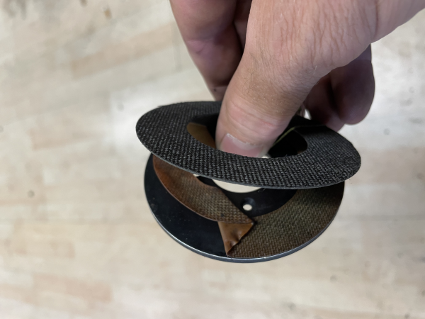

Robert Janssen
This is the Rob trick

Rob - I have the one on the bottom.  I ended up cleaning it up as you suggested.  It turned out much better so put some cal's drag grease on it and installed it back in.  I think the top one pictured was the updated version if I am not mistaken.  If you are interested in selling one (or both) please let me know.  It would not hurt to have 1 or 2 as a backup.  Thanks!
