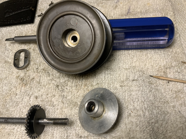

Questions: the aluminum  drag knob; it has what appears to be a heavy-duty spring, sealed up inside. Can't see a purpose for it. The knob presses down on a keyed washer sealed inside of the middle of the spool. Also there is a screw in the top of the drag knob that goes from one side to the other to... act as a stopper, maybe? Is that a spring up in there? And what purpose does the screw serve?
Can't see the spring lookin thing too well but that's the best picture I can get. Tap on it.

   The spring is to aide in drag tension .    I think the screw is a set screw to hold the spring cup up in the knob  .
Quote from: oldmanjoe on October 05, 2021, 03:29:08 PM
Yes, Joe is right — the spring aids drag tension at the lightest of settings.

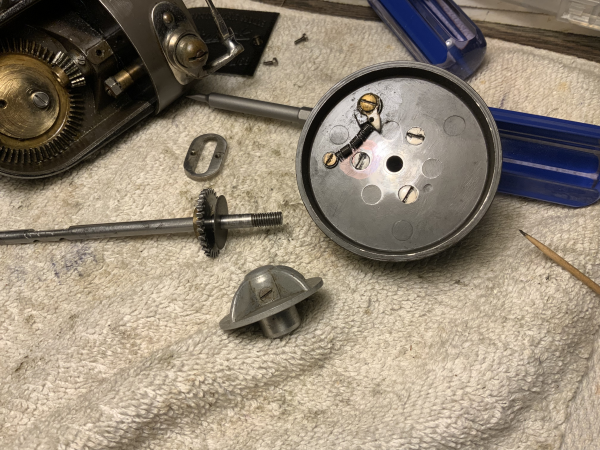

Myself, I only had one real issue: there's 3 screws that hold the 2 spool half's together. 2 came out, 1 is gonna break or strip, as it won't budge. Black circle around it in my picture. But, no reason to take the spool apart because the keyed washer in there is in good shape and spins(actually the spool spins around the washer, while the washer is held in place by key-way in the spool shaft).

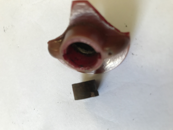

It seem's there is a missing part—something that would contact the keyed spool washer and push up into the spring as torque is applied to the drag knob—-a small washer of some sort?
If you're still with me, please look at the 3rd picture.

Ok  i am with you . :) :) :)    Don`t bother with removing the screws in that spool , no real help at all .
    I presume under that key washer there is one friction , or is there none at all ?    Looks like none at all .

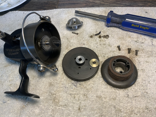

Ok. I DID IT! After 5 yrs. of owning this reel, I finally got that spool screw out. Fred's long ago advice about tighten slightly first, then try to lossen, and Wayne(El Pescador)'s gift of these Bald Eagle hollow-ground screwdrivers = success(hada use a .045 size cause of the damage).
No washer except the chromed brass keyed one, in the middle. The bottom of the drag knob presses the keyed washer into the bottom 1/2 of the spool (worn looking—aluminum colored area). The 65+ year old cork looks interesting. Have one delrin-lookin washer that goes between the base of the spool and the drag-click-gear-spindle. Am I missing one somewhere?
Maybe I just don't know spinner drag knobs, and what the spring is supposed to accomplish... Could the spring in there function as something that just keeps the knob from turning with the spool as it turns, when line's pulled out under drag?

Now that I got the spool split open, will put a delrin washer directly below the keyed middle-of-the-spool chromed brass washer, but will haveta to do some sanding. As it is now, the only drag washer friction point on the spool is at the very bottom. Below the keyed washer looks to be metal to metal, under drag knob pressure.

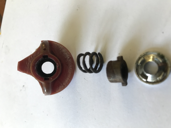

I have a plastic one to take apart.  Were you see the brass nut with ears that slide in the channel in the knob.  I think the one you have has a oblong slot that the screw rides in instead of ears
