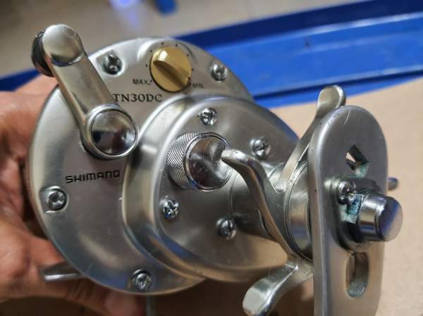

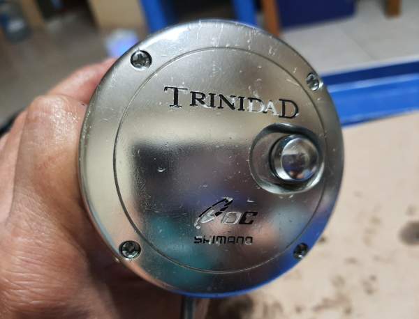

well this my newest acquisition for my personal arsenal, I just got it in my hands, one Unicorn reel, the mighty trinidad DC reel size 30.
for the meantime I will only showing it off  ;D ;D
later in few days I will open it up to check internals but I know its pretty much a normal trinidad 30 with the DC system, clicker dog and taller/bigger ARB, btw, this ARB feels solid as gold!!  the handle turns and feels pretty solid compared to the normal gold trinidad reels which feel pretty smooth but thats it, this one feels pretty smooth but steady and solid
love the drag star, 5x better than the ones used on the gold trinidad ones.
my plan is to do a complete service to it, fill it with some 80# braid and go to the beach (dry sand only) and test the DC system.
I really dont have plans to use it soon since have some reels on the same category of line and drag and also seems that some guys look for them as collection item.
so, what do you guys think ?
this Unicorn is a shelf queen candidate or a weapon of choice for fishing trips?

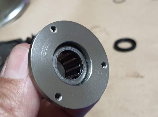

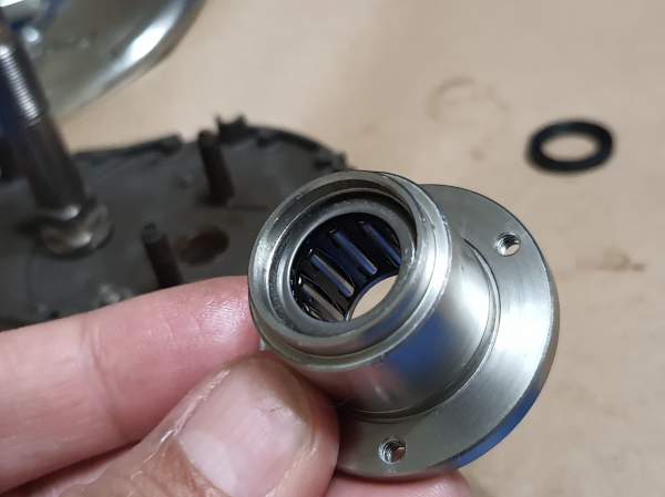

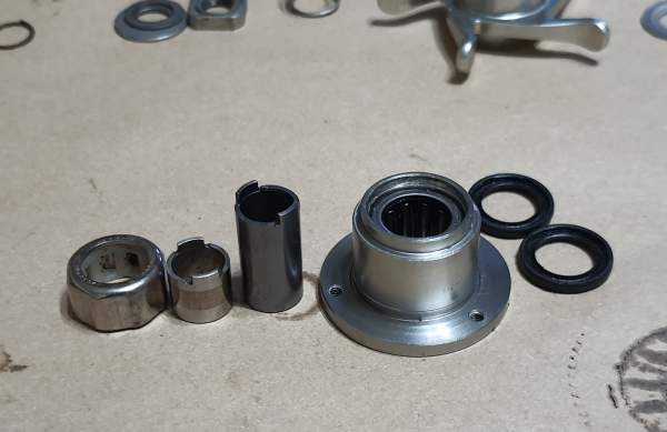

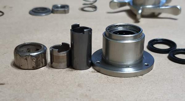

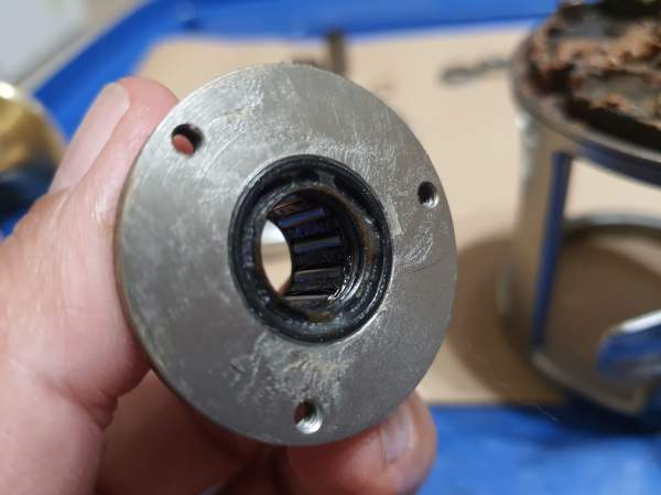

- AntiReverse Bearing (ARB), on DC is double the size and it also have two big plastic/rubber gaskets one on each side of the ARB to prevent saltwater intrusion to the ARB which is the main reason for corrosion that kills the bearing.

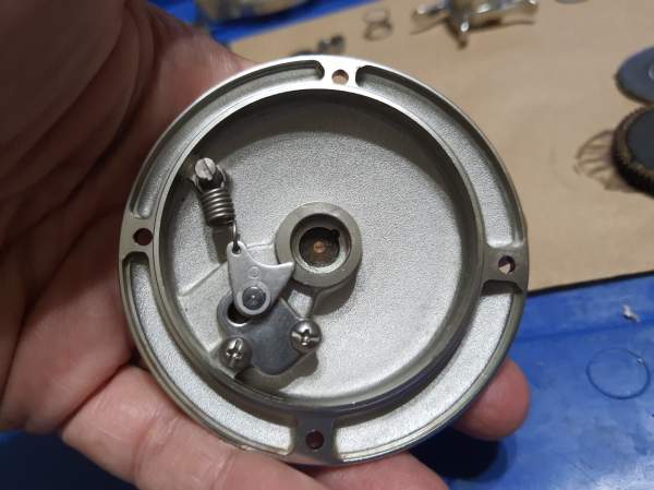

- Clicking dogs

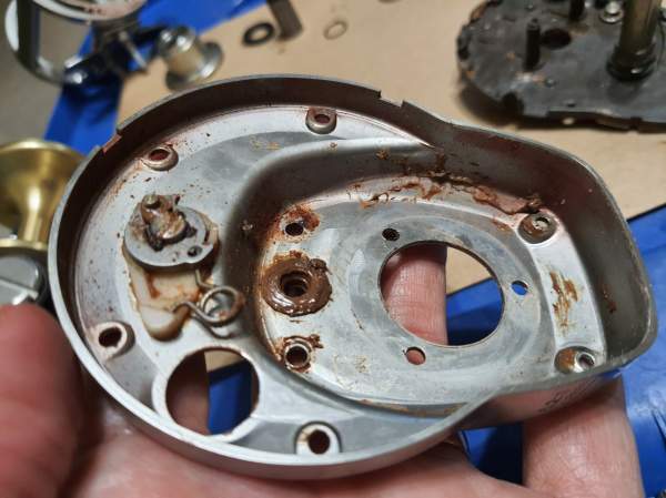

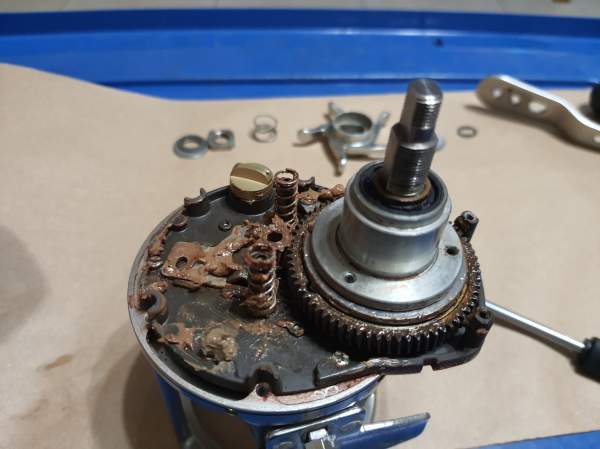

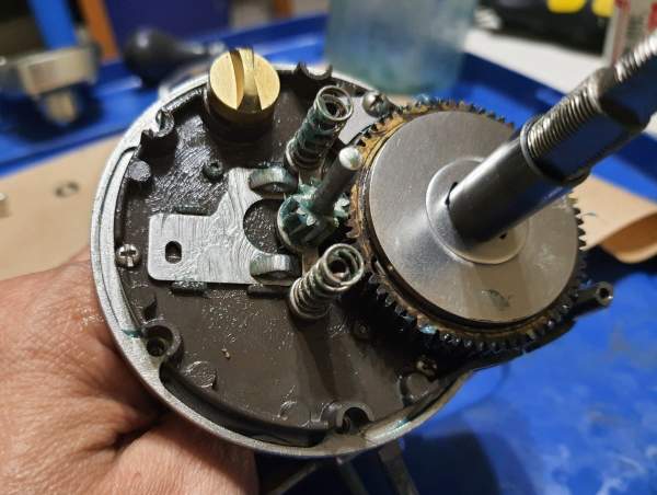

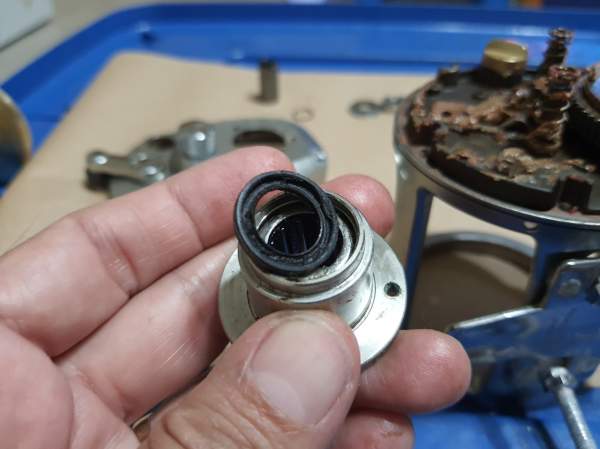

well, this particular 30DC reel had an old grease that turned brown color and got pretty thick it feels almost as mud/clay paste and its also pretty sticky, I cleaned all that up and put a light coat of yamaha grease all over the internal walls and gears, etc. in short I Alantanitazed the reel, the bearings of Spool, left side plate and right side plate where opened up, cleaned and left them open  with few drops of WRL 191S OIL (thanks Fred for the oil ), as expected the reel now feels pretty smooth and the big ARB make the handle feels pretty solid, it feels pretty similar to the Talica 16 single speed.
this is how it looked with all the old grease, what a mess right?

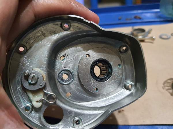

with the brown residues of the grease all over the sideplate I couldnt know if there was corrosion at any place until I cleaned everything up with hotwater and dishwashing soap, for my luck I found out everything was in pretty good shape and corrosion is pretty minimal to almost non existent, so, I proceed put a light coat of yamaha grease and called it done

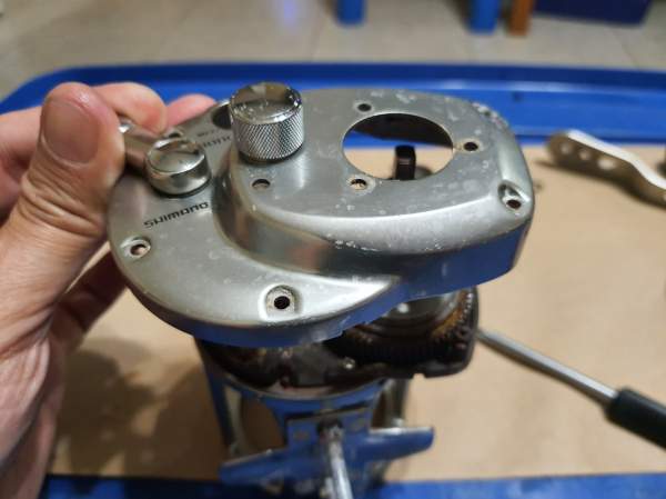

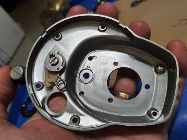

this is another difference against the regular gold trinidad reel, as you can see the left side plate doesnt look as "busy" as the regular gold trinidad, this DC looks cleaner, simpler and easier to service compared to the gold one.

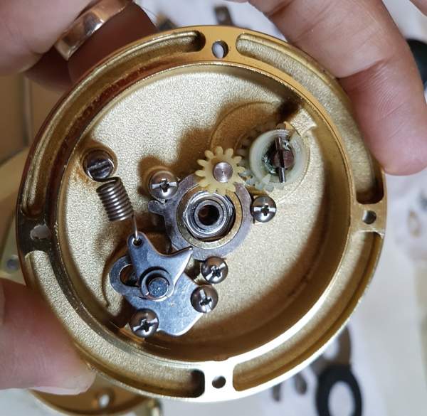

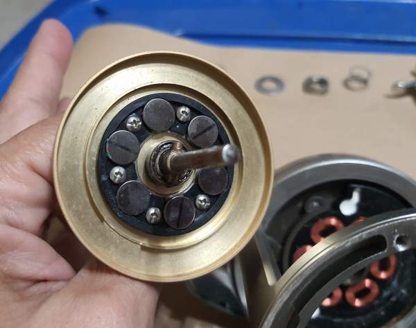

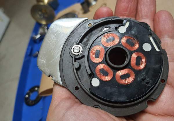

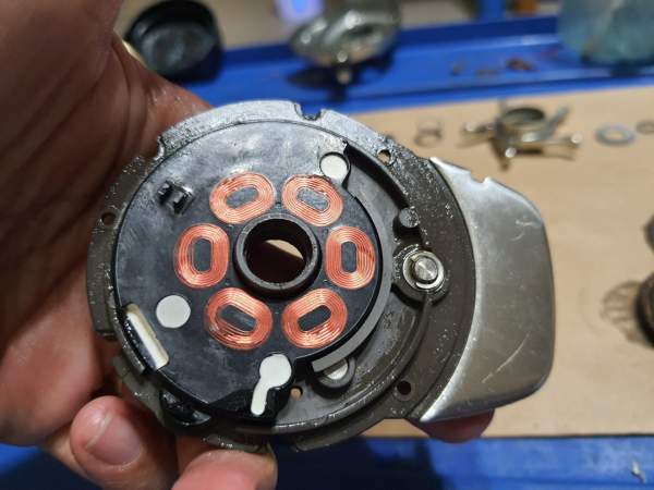

Now, to the holy grail of the reel, the DC System or Speed Digital Controlled system, which is a circuit that controls the speed of the spool when you cast, helping you to prevent backlashes on windy days or just to make you cast without worrying on know how to apply light pressure to the spool to control the speed of the spool, in short, you dont need to know how to cast with this reel, they DC system will make you cast as a professional everytime.
I will separate the the DC system in three main pieces:
- the DIAL knob with 8 control adjustments
- the Circuit at the back of the Set-plate

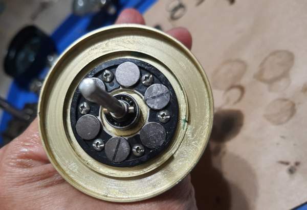

- the Magnets on the spool, I think (because I never found any information the way the DC system works) seems the copper wire coils create an eddie current that hits the magnets on the spool depending on the speed of the spool making it to slowdown or keeping the spool speed depending on the lure weight, windy conditions, etc.

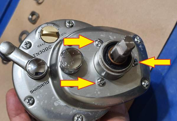

the other BIG main difference Vs the gold trinidad reels is the size of the ARB, check the next comparing pictures, also in the trinidad DC reels, the ARB housing can be separated from the sideplate by 3 screws while is the gold trinidad reels the ARB fits in the housing that is part of the side plate, in order to clean everything good before taking this reel to the water I separated the ARB housing as a whole, cleaned the rollers of the ARB up, cleaned the two rubber gaskets from each side, added oil to he ARB rollers and coated the rubber gaskets with grease before put them back on their place, that will help better to keep saltwater out from reaching the ARB rollers.
Regular ARB and sleeve tube of the Gold trinidad at the left and Sleeve tube, ARB housing and rubber gaskets of the DC reel at the right side

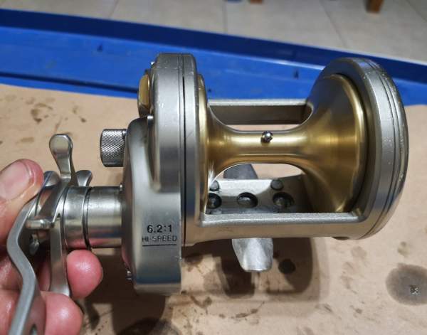

the reel cleaned up really good, I could get rid of those watermarks on the exterior of the reel and now looks pretty good and silvering shiny

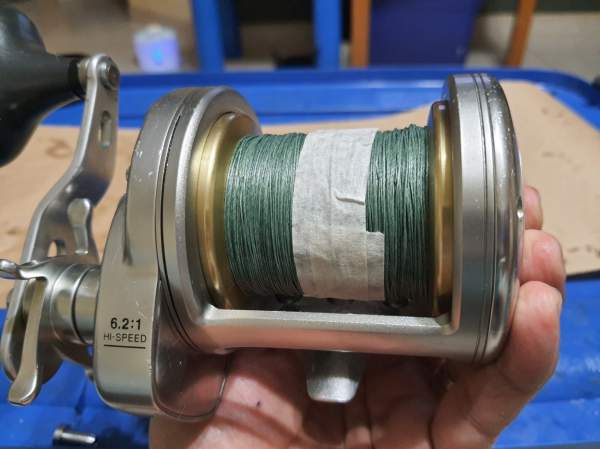

and its already filled with 80# braid to go to the beach and test the DC system and at the 1st fishing trip take it with me to catch a nice fish with it.

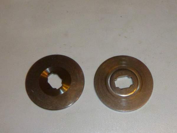

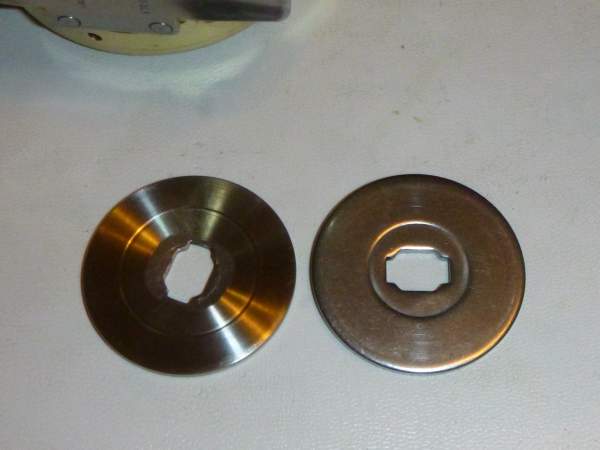

PS: I will use the reel as is, but I still can add the Cals drag place from my trini 16 to this one, it supposed to add more steady drag pressure to the drag stack, btw, the trini16 is gone but I kept the Cals drag plate that it was installed on it.
Cals drag plate top at the left and stock trinidad drag plate at the left
Bottom side, which have more flat bed to to have more contact area with the last carbonfiber washer
You need to fish with that one, made for casting,no point in it being a dust collector
Nice!
Just me, but I'd line it up for one trip, have fun testing/fishing it, then shelf-it after disassembly, cleaning and re-lube, as you planed.
If it were a NIB 20 DC I'd put it away as my kid's college fund.
OK, understood, These boots are made for walking and that's just what they'll do  ;D ;D ;D

I've always wondered if that little electric generator thing could stand up to saltwater use.  Hopefully, if it gets wet it will hold up better than an i-phone.
hey Steve, I still havent tried the reel to check if the DC thingy is still working but seems to be covered with a coat of rubber/urethane or something alike, pretty sure the engineers of shimano were sure to add something to protect the electronics.
