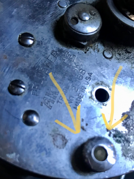

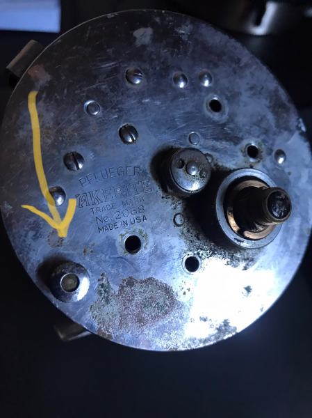

I've got a pair of these a Akerite reels and want to make one goo working on out of another that has some parts missing.    That said how do I get the crank side plate off?   A picture might be a clue as there's a spring loaded small knurled knob that might do something similar to the jigmaster?
    Any help would be appreciated.    Thanks. :)
Yeah, Gary —
Just slip a paper clip under the pull-out button to help a stubborn head plate so you can two-hand rotate it counter-clockwise.
Just similar to a Penn Jigmaster, Squidder, Surfmaster, etc..Actually a stronger take-apart system than a Penn.
Wompus Cat
They can be a Bugger Bear as the bakealite swells over the years and makes it damn near impossible to turn . If you are lucky and you get it apart GOOD .If not post back and I will show you how I get them apart with out Damaging them .
TOUGH REELS once you get them working !
### NOTE That Pin unscrews on most of the Pfluegers  then you pull out on it then holding the Reel in you hand with the Handle on the Right side twist Backwards on the side plate .  Do not Pry   on Cross Bars  or the Lil Screw Tab !!!!!!! .
Tanks y'all,   With your advice and some tapping and spraying the side plate gave up and untwisted just like the jigmaster.   The pen was mightier than the sword 🗡, hammer 🔨.
   These reels seem to be built for fishing them for a lifetime,  and thanks for your advice.     ✅ done.👍🍻
