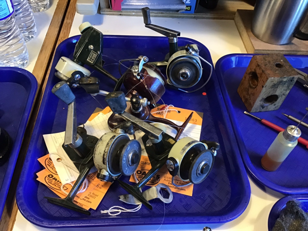

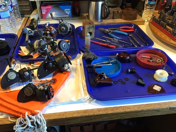

Light breakfast — started working on finishing up restoring and servicing (9) reels for a client back East.
He sent me 24 DQ's a year ago — which I completed full restores on for him.
Then he sent me (9) more for the same — 2 DQ 110's, a Finessa 285, 4 Cardinal 3's, and a couple of Shakes 2052's.
All (33) reels were eBay or yard sale specials.  And all will be ready to go another few decades of catching fish.
DQ's got full restores including paint — the Shakes & Cardinals will get full disassembles, cleaning, removing crud and rust, replacement of any key worn or cosmetic parts — but no painting.  Might get the last (6) done before dinner tonight.  We will see.  Depends if there are any issues that end up being a slow-down.

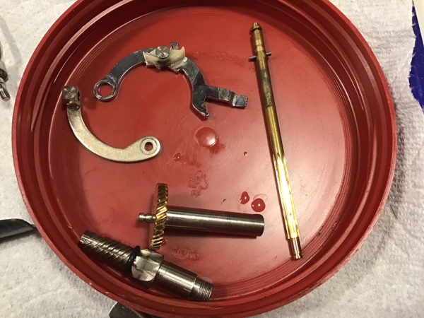

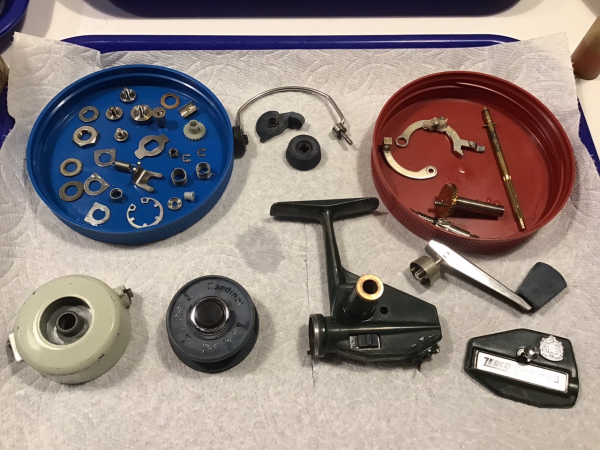

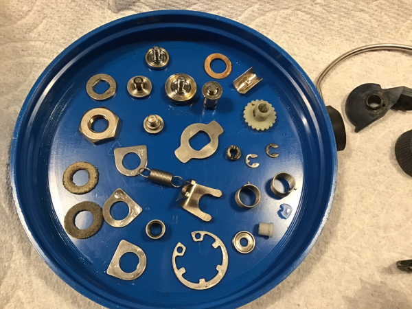

This was the roughest and dirtiest of the (4) Cardinal 3's —
All of the white nylon parts were black with years of grime & crud.  All of the metal parts seemed close to ruin.
Even the two bail springs were black with crud and grease.
Amazing what lacquer thinner, HD Dawn dish soap, and an Ultrasonic Cleaner will do.
I'll install new drags, a new drag knob, a new spool, service, reassemble, tune, and fine tune all functions — and it should be back in the batting order.

Well done, Maestro! An USC probably really helps getting the crud off those nylon parts. I don't have one so I just use lacquer thinner, a Q-tip and that little wire valve brush to get rid of that stuff. That process works pretty good, though.
At least that 2052 has the metal metal bushing on the main shaft & not the later plastic one. Shakespeare never had a metal spool for the 2052. I guess they figured that the plastic spool was good enough considering its intended use. I think it must have been a good formula because I've never seen or heard of one breaking, like some of the other reel makers' plastic spools.
Quote from: Midway Tommy on November 22, 2021, 03:58:40 AM
An Ultrasonic cleaner is not necessary on these reels — the same result can easily be accomplished without a US cleaner.  It just takes extra time and effort to let things soak away overnight.  Although I think that the US cleaner gets into every little hidden nook & cranny — and a decent US cleaner is not very expensive.
For speed and efficiency — I can do 4 times the reels in the same amount of time — with much less effort.
Used to overnight soak the reels in HD Dawn, Simple Green, Purple Degreaser, and Lacquer Thinner — depending on the make up and finish of the part — but after going to a US cleaner over 20 years ago — I would never go back.
