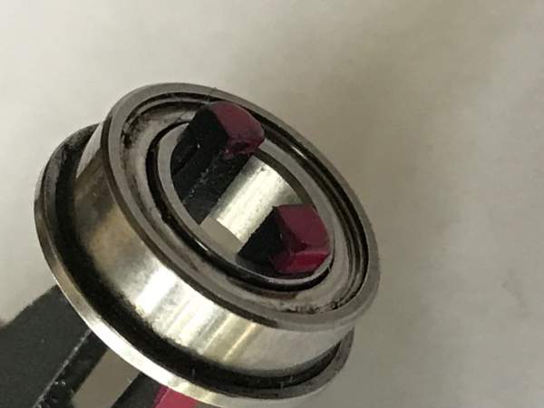

  I had a gooden  stuck bearing in a cup ...       The usual bent bars were not getting it .

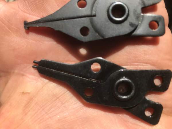

  I picked up another 6 dollar snap ring pliers to cut up a set of jaws .

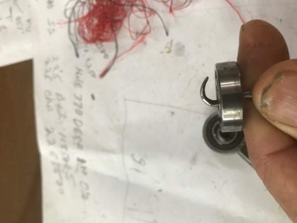

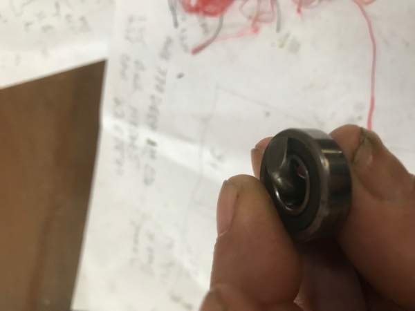

    I picked the straight one and did a little grinding and cutting with a dremel cut off wheel to make this profile , a side by side picture of the two .
   Here is a picture of it holding the bearing , i was able to hit the cup rim to free it up.

You're pulling the bearing out by grabbing the inner race.  Sometimes you just do what you gotta do to remove a stuck bearing.  But, pulling on the inner race can warp the cage so the bearing has to be replaced if you want it to preserve the free-spin time,

It's not a thrust bearing.  It's a radial bearing and was not engineered to take pressure from that direction.
It's easy enough to prove it to yourself.  Measure the free-spin time of a bearing. on a mandrel.   Anchor the outer race and then pull on the  inner race with your gizmo.  Then check the free spin time again using the same technique.
